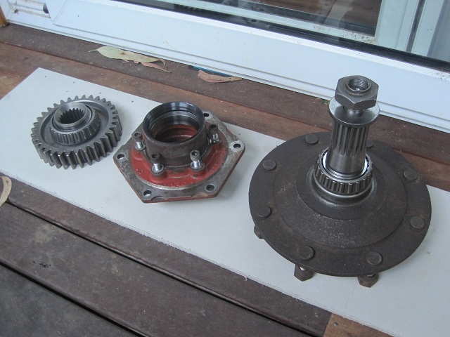

And a picture of my hub dismantled...

- Hub in Pieces.JPG (109.02 KiB) Viewed 9290 times

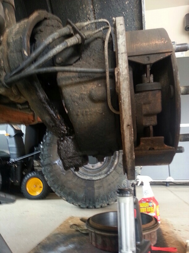

All right, I finally had some time to take the front right wheel off to trouble shoot. The first picture is an overview, the second shows a close up and there is a drop of oil forming on the top. I thought that whatever is below the cv boot, is grease lubricated, not oil. Any ideas? I am about to pull the planetary gear assembly off to get to look at the boot, but it involves disconnecting the brake lines etc. before I do that, I'd like to make sure it's what I am looking for.

- image.jpg (166.48 KiB) Viewed 9188 times

I'm pretty sure its the CV boot. Feel around it a look for a split in one of the valleys.
