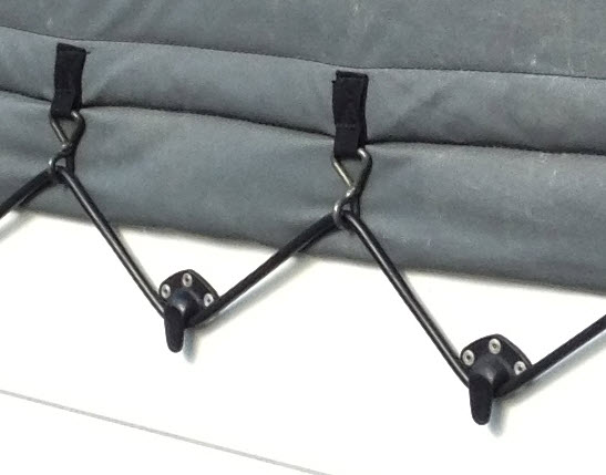

Does your top have loops like these or have they changed to just rings - can you post a close up shot?

The rear top I had made last summer/fall came with just rings. The rubber cord holders like in your photo are still available from SAV but probably add a bit to the price. http://www.pinzgauer.com/showdetails.ph ... 111870181/

Take the old ones off the top you are replacing and send them to Tuff River to use on your new top.
These things are not cheap.

Those rings are a much better option. Here's what I was talking about. See how the round ring is bunching up the webbing that's holding it? And also how it's twisting the webbing? Maybe it'll be fine, but I wonder if the stress will make it tear eventually.

Use 'D' rings. flat on the side that goes through the fabric loop. No bunching.

I agree. Part 26-15-09, 7111870191. $2.09 each vs. over $8 each for the double loop ones. Unless of course you really like those other ones (7111870181).
'D' rings are also available in stainless at McMaster, 34905T91, $2.57 each but they may be too large.

For D-rings, check www.strapworks.com, I always had good experiences ordering from them.
$1.30 for 3/4 inch stainless, add $0.50 if you want them powdercoated olive drab or black (or any color you want...).
