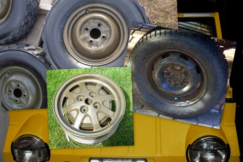

Re: 145r12 Yokohama Super Digger II's
Rim on Mayola's is a stock Hafi rim
Black rim is a Fiat 13" steel - pretty close to stock (what I am running on my Hafi sorry for crappy photo)
Then again - not a ton of selection for 13" rims either!
There are 14" aluminum Lancia rims out there too (photo is of Westernair's)
- Haflinger - CA - Mine.jpg (52.65 KiB) Viewed 22693 times

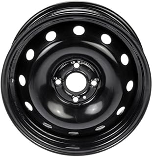

Shhhh - don't tell anyone but the new Fiat 500s uses a 4x98 bolt pattern which may work
I picked up some Fiat 15" steel rims PN 61659 as they were free
They are 6" wide however!
Technically you could slap on a set of Abarth rims
15 inch Fiat 500 wheels, plus sidewall and tread height might get hung up on the body under load/bounce.
Also, the offset is gonna need spacers, pushing 6 inch wide wheels out quite a bit.
I'd like to see it applied, but it's not "plug and play."
Agreed - it is the offset that I want to check oncascade.king wrote:15 inch Fiat 500 wheels, plus sidewall and tread height might get hung up on the body under load/bounce.
I do find it amazing that they stuck with 4x98 however!
