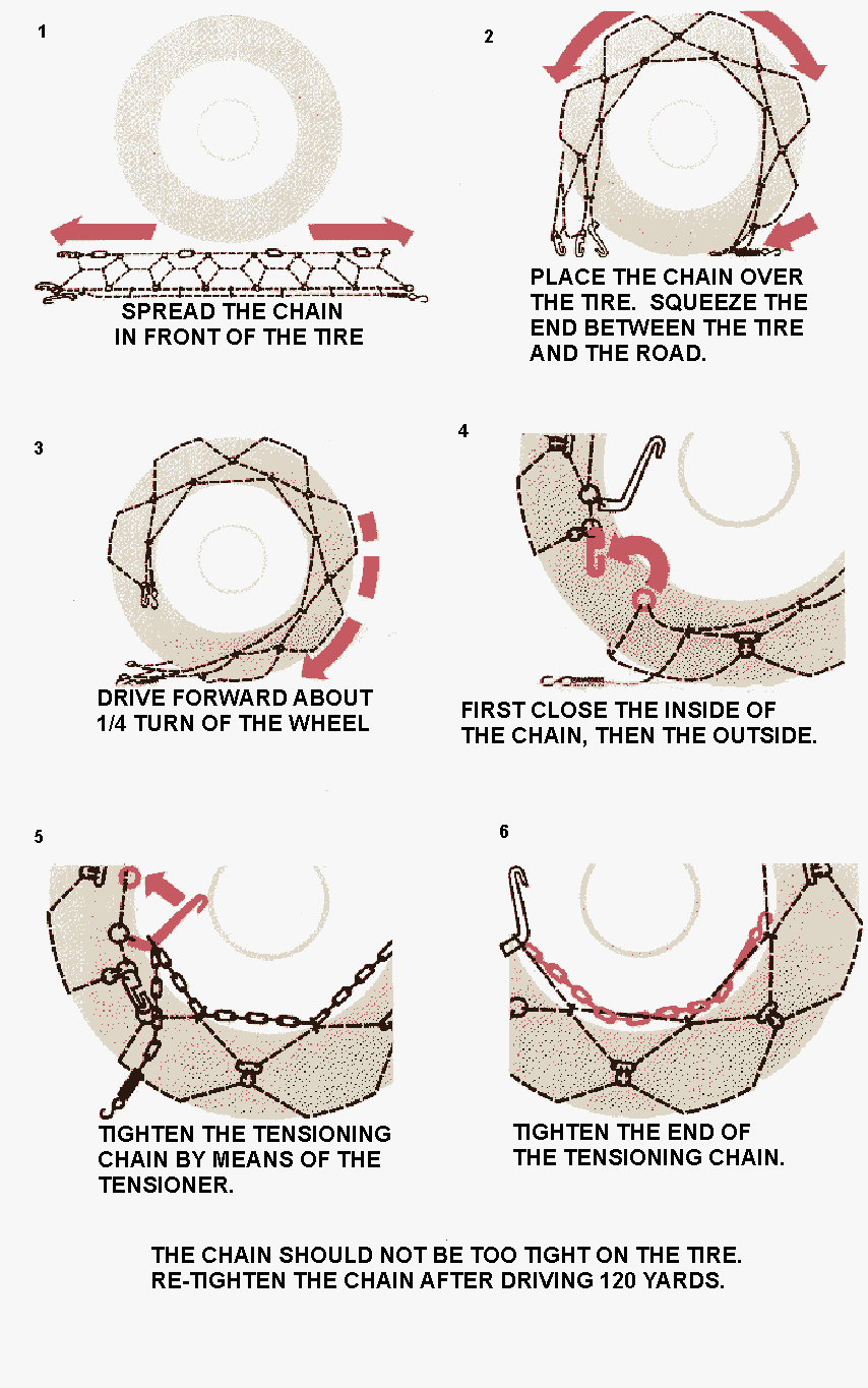

Could anyone provide a quick tutorial on how to install the original tire chains. I wanted to put them on yesterday for our ice storm but I wasn't sure I had them on correctly.

The official guide: http://web.archive.org/web/200708131405 ... tions.html
I've found that if you have a clean, dry surface (i.e.: garage floor) it's easier to just jack up one end of the Pinz and install the chains with the tires just an inch or so off the floor. Then switch to the other end. No need to start and drive the Pinz, just rotate the tire as you drape the chain on.

Thanks! That's exactly what I was looking for..

I have only put the chains on once to see if they fit my tires. I used a small (4 inch) piece of 2x4, placed the chains out flat and put the wood in the center and drove
up on it. Gives the right amount of space to maneuver the chains around to fit. I keep the two pieces of wood in the tool compartment.

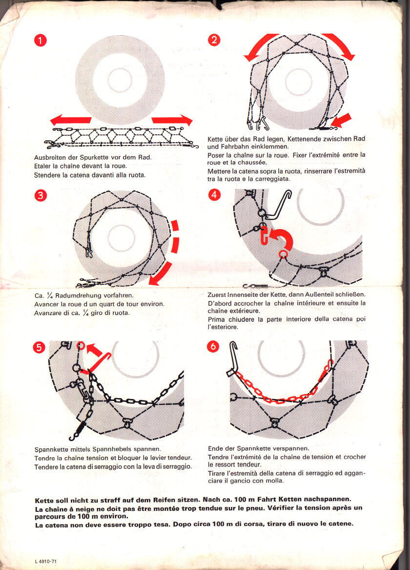

images for archive
Chain Install-L.gif (52 KiB) Viewed 6210 times
Chains, snow.jpg (205.03 KiB) Viewed 6210 times

Make sure you test fit your original chains before you actually need them. Most of us are not running the same tire size as the original maloyas and will need extra links added to them.
