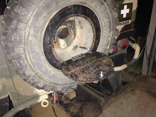

If I were you I would make one (or have Andre fab it) or use the empty space in the rim for storage - I am attempting to make one of these:
Storage Compartment.JPG (42.18 KiB) Viewed 21590 times

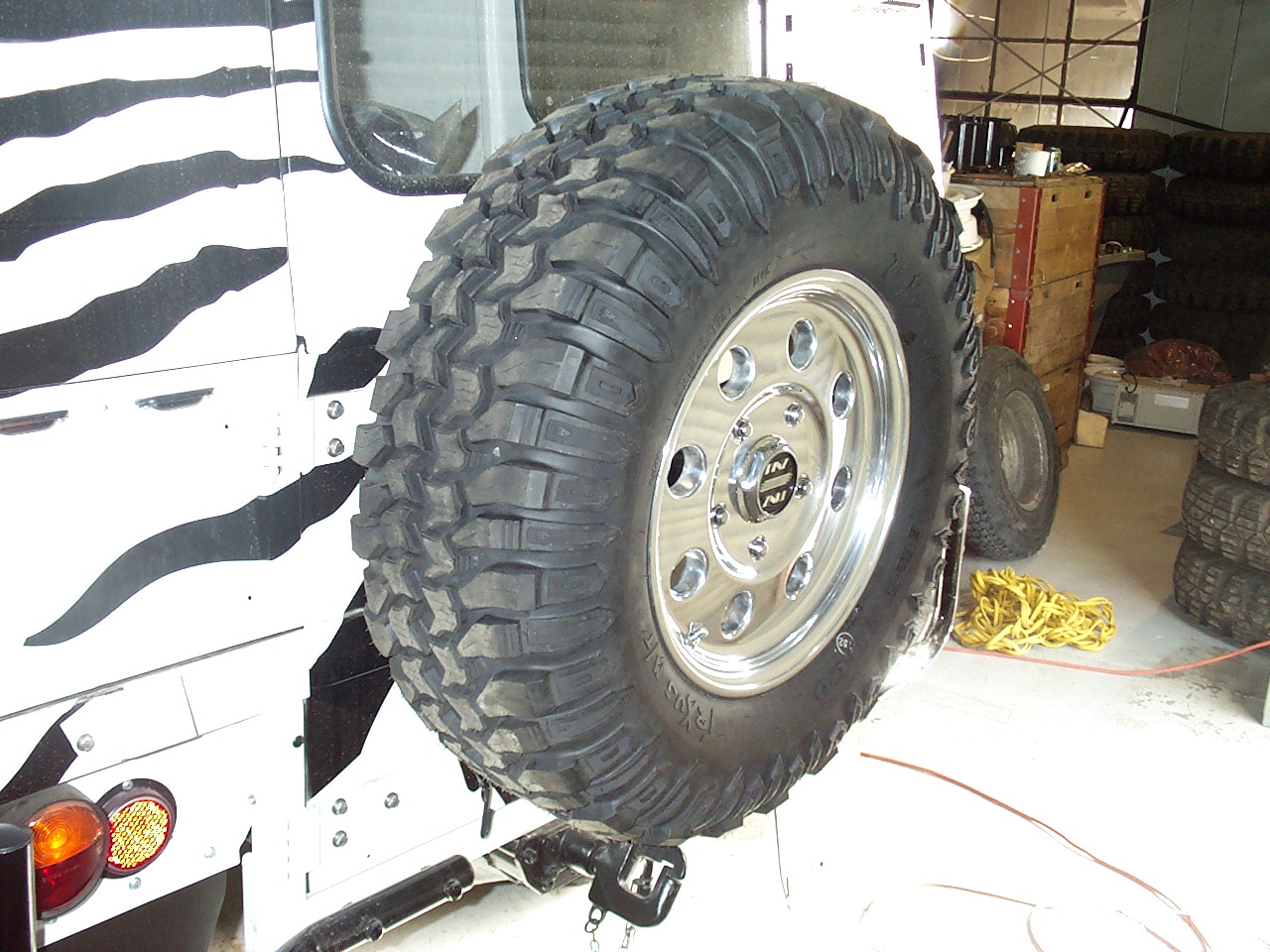

That's a good idea. I'm getting a set of wheels from Tom Cepek,
and since I'm getting such nice wheels, I want them to face out.
I'll check with Andre since it's something he could easily ship.
Here's a pic of a 712 with the same wheels:

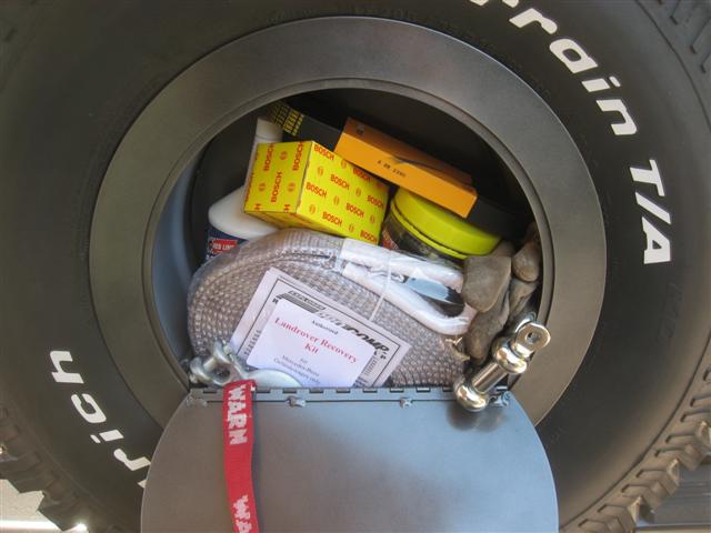

I really like that spare tire storage.
Re: Spare Tire Mount
I like them too - except for the price! $474 USD - usuaully a G-wagen item for those with deep pockets I guess... I've considered making one using the laser cutting table at a local maker space I just joined... but too many other projects are more pressing.
https://www.g-wagenaccessories.com/prod ... lcover.htm
Here is a good shot of one open and empty:
resized closed.jpg (235.2 KiB) Viewed 19971 times
resized open.jpg (86.08 KiB) Viewed 19971 times
This is what I came up with. After cost of water jet materials and hardware, I can get these out for $180 and have a modest profit.
Call it $210 with P/C and a sticker.
