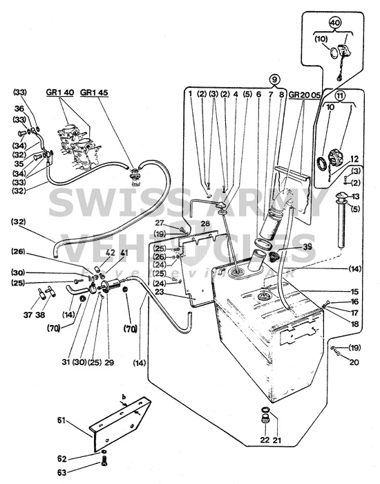

If you take a look behind the passenger seat at the gas tank fill pipe, you'll see a smaller metal pipe that comes off the rear of the fill pipe and goes down thru the floor. This is a vent pipe for the tank. The pipe connects to that hose covered in goo and the hose than goes back into the tank.
That hose is #14 on the following diagram:
- 01-50.jpg (120.39 KiB) Viewed 6719 times
Most likely that hose is old and is weeping gas slowly. The fumes probably just evaporated.

If you drop the tank replace the two cork gaskets #5 in the drawing at the tanks mating surface for the fuel pickup tube and the fuel level sending unit. That's where mine was leaking and exhibiting the same appearance, I replaced all the fuel line going to the tank at the same time. The large fuel fill tube was fine on mine.
