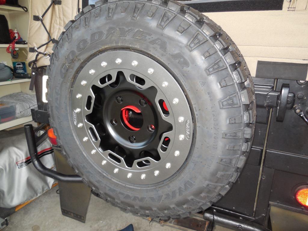

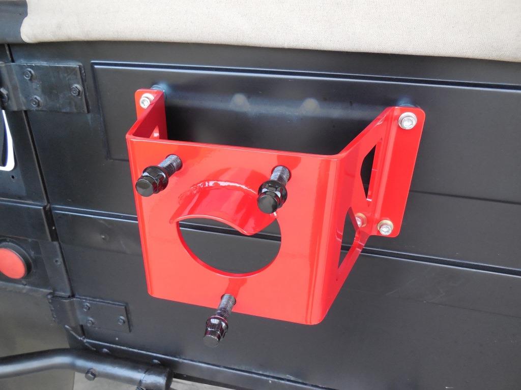

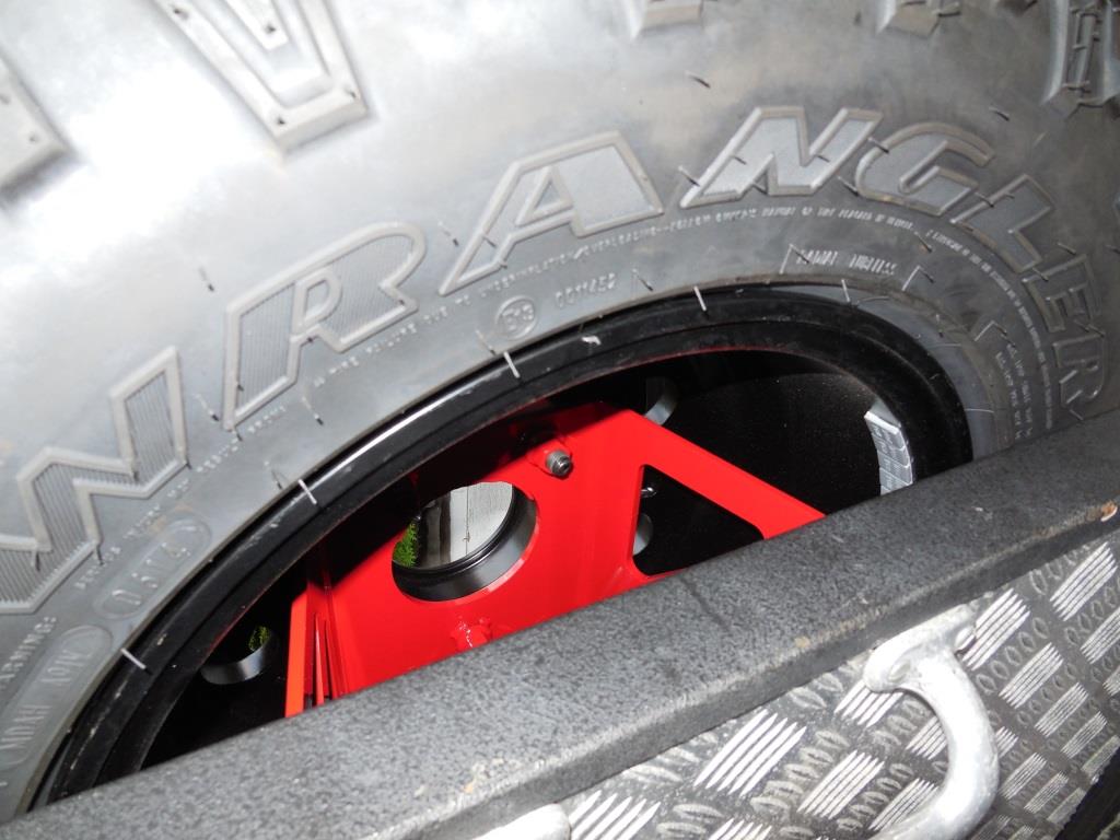

Here is another way of doing it. Not better or worse, just different. Studs are security type with a matching driver head to prevent theft.
Unit is bright red for visibility while changing tire on highway (besides, I had a batch red to go to powder-coat and I'm cheap)

Nice solution for a hangar. I like the little tongue thing. It should
stick out just past the lug nuts, like on the original. I found the
original tongue was very helpful so you could lift the wheel into
place and not worry about lining up the holes with the lungs until
it was resting on the tongue. If there was one addition to Andre's
design that I would add, it would be that tongue, like on the original.
Nice hangar. I'm assuming the lock rings are custom?

Thanks all. The tongue was necessary because the "studs" are actually bolts not studs, so the wheel can be lifted and just sit there while one bolts it up with the special security driver socket. I have hurt my back several times trying the "thread the needle" while holding up a >100lb wheel on my Landcruisers. About the wheels, they are the GT Pinz wheels 17 x 8.5 with OMF rings. I was able to weld the mounting rings on easily without stripping the paint. Then, bolted up the beauty rings that were painted anthracite color. (fake bead locks...street legal that way). To those that are asking about making some of the tire holders, send me a PM and I'll see if there is enough interest for a short run. If Andre has a laser and a brake, I'll send the flat layout to him gratis.

bikmakr wrote: To those that are asking about making some of the tire holders, send me a PM and I'll see if there is enough interest for a short run. If Andre has a laser and a brake, I'll send the flat layout to him gratis.
Beautiful solution to a common need. Feel free to build as many as are requested. I have often considered getting a waterjet or plasma cutter to improve my productivity. I just need a more commercially friendly location so I can pay for itself.
I wanted to put that tongue on to help with mounting as I like it as well. I just wasn't sure of the size of the center hole on the rims that were to be mounted on it.
Had the rims and tires been here. I would have been able to make them without the worry of fitment issues.
