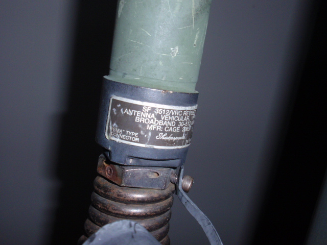

Or you can install the later version Shakespeare SF 3512/VRC 30-512MHz that works without having to turn switches and still looks like it belongs on the Pinzgauer. good for 30-512 MHz with out any adjustments
These can be found on line or at military swap meets for much less than some of the internet sites list them for, however it will take some hunting. These guys list them, a bit rich for my blood however it would save the hunting. https://www.american-milspec.com/p-6600 ... a-new.aspx
Still won't give you much in HF but that's what screwdrivers are for. :lol:

The main problem with the stock antennas is having to manual switch the frequency settings on the base. Being that my truck was missing the masts it was easier for me to justify going to the newer antennas my cost was ~$100 per side IIRC at a military vehicle collectors swap meet that David introduced me to, great bunch of guys a few with good military radio experience and knowledge of what would asn would not work for amateur radio.
