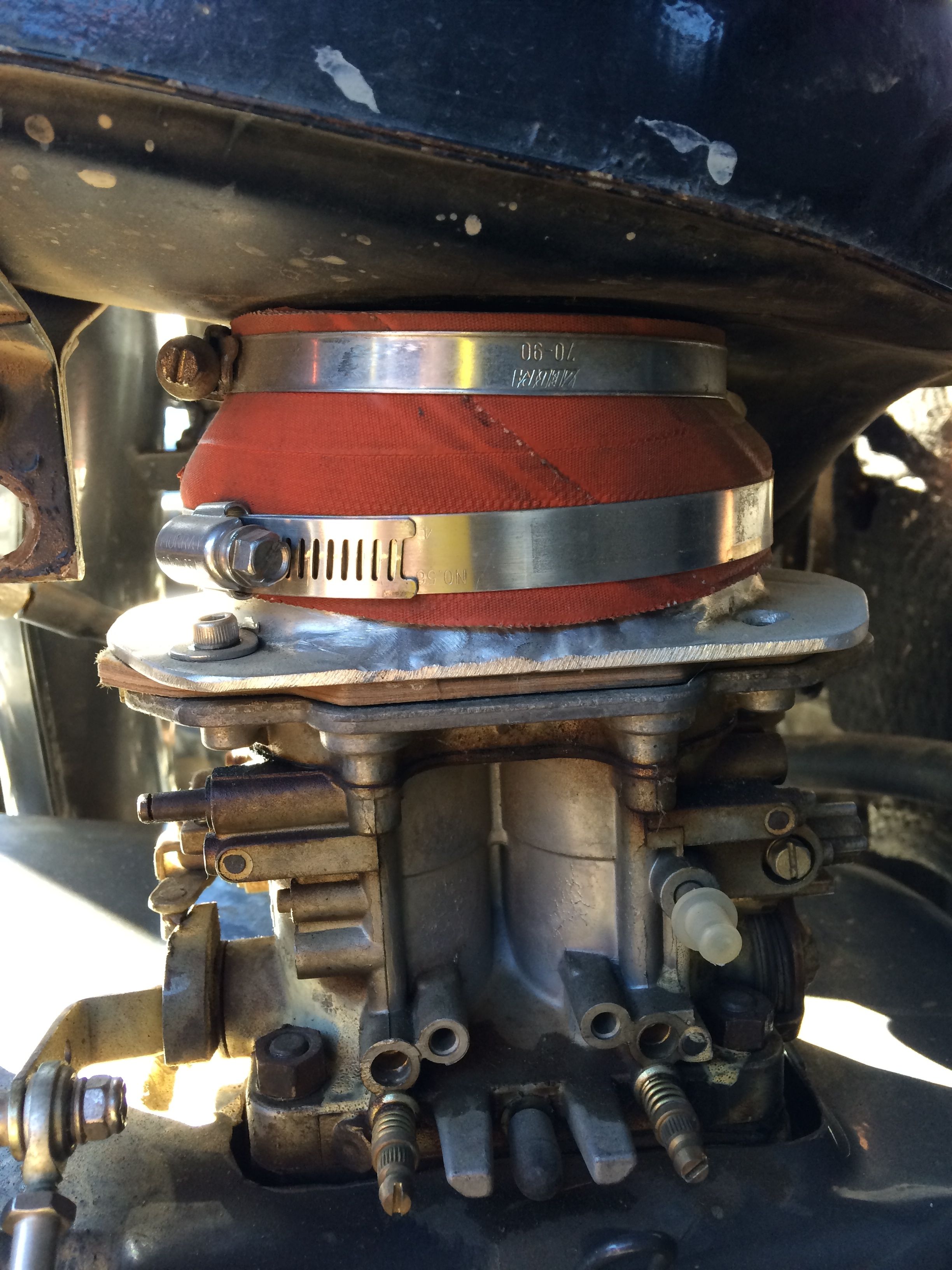

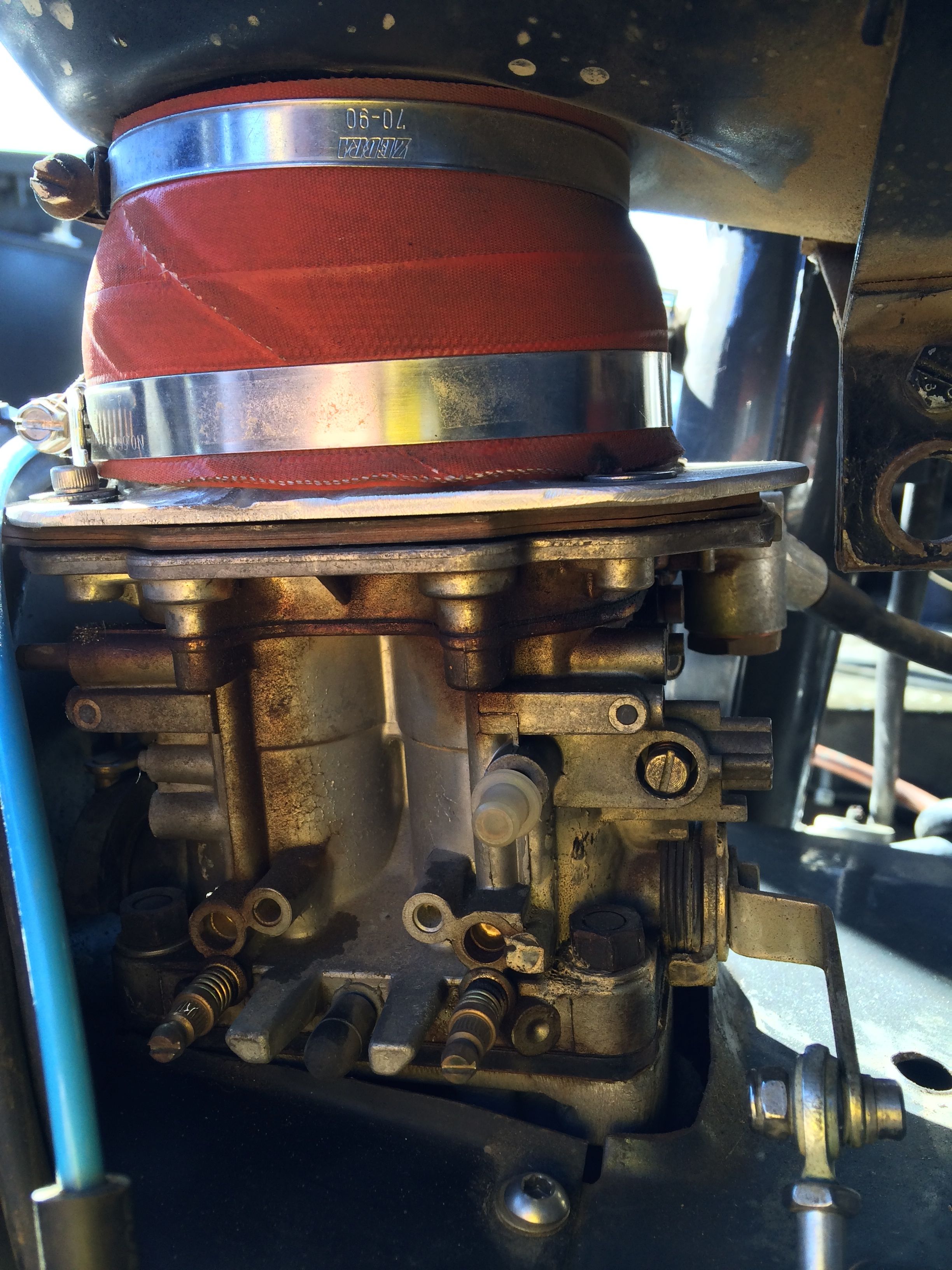

I recently purchased a Pinz 712M that had a complete engine rebuild, upgraded from 2.5L to 2.7L and 2 Weber carburetors 36DC NVA 18 (instead of the Zenith).
I'm not sure, if that's a good thing to have Webers on the Pinz; so I'm on the fence what I should do:
a- build this back to the Zenith Carburetors
b - leave it as is
...or c- take a leap, and go for EFI.
What's your opinion how best to use the $ on the Pinz?
Should I build back to Zenith from Weber carburator?
- Back Weber 36DC NVA 18
- Weber 36DC NVA 18 - back.jpg (773.83 KiB) Viewed 5082 times
- Front Weber 36DC NVA 18
- Weber 36DC NVA 18 - front.jpg (981.54 KiB) Viewed 5082 times

You look to be missing a few screws ....(I mean on your carb flanges don't take offense)I can't see it running great I think you'd be sucking and blowing on the less than sealed flange. Fix that and if runs good wait until you carbs aren't treating you well.

@Mopar: You're right. Curiously enough, one screws was missing on each carb each (not sure if by design / mistake / or due to vibrations)
