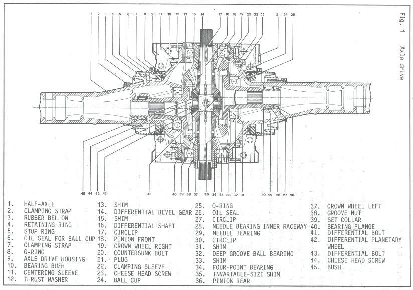

Talked to willy at SAV and ordered the seals to do the job but can't find a detailed schematic of rear diff. The only one I can find is on the SAV website, group 03-01, but it's not really detailed...four O rings?seals need to be replaced. Does anyone know of another detailed picture of the rear diff/locker box area. Thanks again Zig

Repair Manual?
See Sec. G Pg. 2 Fig.1 Axle Drive Cross-Section View

SAV only shows gears on one page and case, etc. on another. The Repair Manual page I referred to shows the whole caboodle in place, as a cutaway.

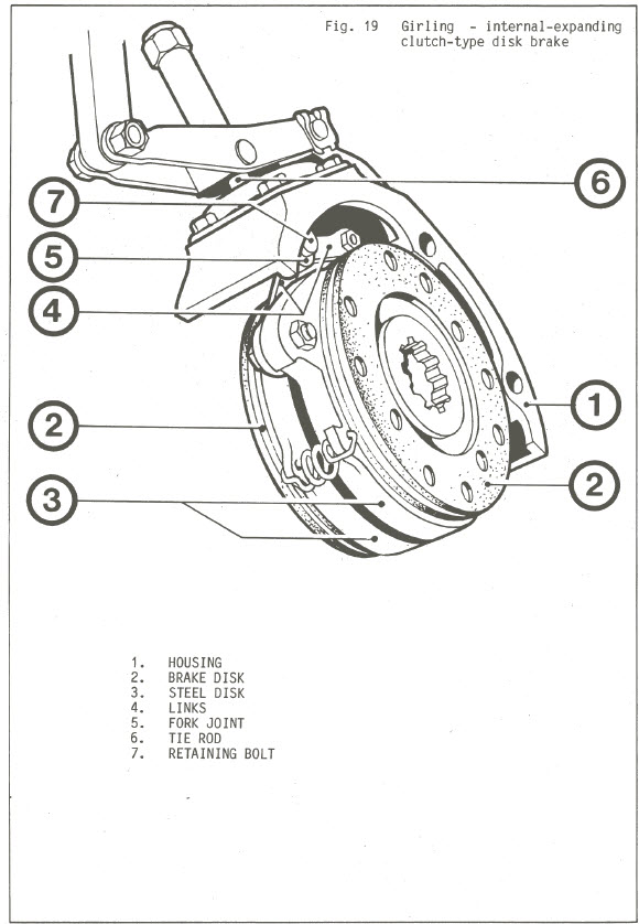

Check Sec.K Pg.22 for a pic of the e-brake assy. There's nothing that shows those two areas together, to my knowledge.

Gpg2fig1
Kpg22fig19

That's the one! Thanks.
