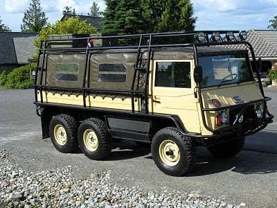

If I recall correctly the stock 710 fuel capacity is 20 gallons, with the spare jerry holding 5 gallons. I see using the space typically held by the spare jerry is taken up by the larger capacity tank, so how much total capacity does the long range tank hold?
Andre made this tank and guard that holds 43 gallons, plus a single additional 5 gallons in the jerry can (behind the small black panel which hinges down for access) giving a total of 48 gallons:
It is just barely higher than the bottom of the central tube but sticks out wider than the stock tank (fits well with the wider rub rails and widened rims). This was done to get the capacity up. This is installed on a 712, so there is less length available for the tank than in a 710. The tank is 16 gauge steel, not stainless. It has an in-tank fuel pump for my EFI setup. No "red death" to worry about, and the in tank pump has a fuel sock to filter without getting plugged. I just got back from a 3500 mile trip over three weeks -- it was so convenient to only gas up about once a day! The unfinished image in Andre's post is of this tank during test fitting during fabrication.

So you made the two fuel cells shown above, Andre? Or did Jim LaGuardia?
I built both, the yellow truck was done in stainless steel and I also built the tank guard for it.
