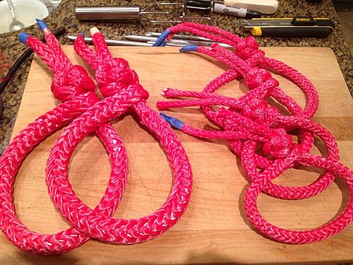

I made some last year: viewtopic.php?f=18&t=8284&hilit=soft+shackle
Fun, easy to make and I had Andre modify the winch mount he was making me to accept the soft shackles (rounded edges). Ask him how much fun that was to do :mrgreen:
Here are the ones I made
Made with Amsteel-Blue (yes they are red)
The four 5/16" have a break strength of 18,500 lbs (Haflinger use) and the two 1/2" are more Pinz/Mog sized with a break strength of 45,000+ lbs
I need to load them and then I can trim the tails.
My video of how they work:
https://www.youtube.com/watch?v=zUlQIgNtE9s
Info:
While knots are always the weak point - these use a 2 strand Diamond Knot
These same shackles, but in 7/16", were sent to Mill Valley Splicing in Mass. and failure was, as expected, at the knot but at 32,400 or 16+ tons (Minimum Breaking Strength listed by manufacture is 21,500) - again these numbers are for 7/16" not the 1/2" and were tested using two 3/4" pins.
Based on Mill Valley's testing the knot reduced strength by just 30%.
I would say they are solid and they have been well proven in the sailing world and rigging for tug boats.
They are super light, easy, float, don't become projectiles and are all the rage in the Euro 4x4 world.
