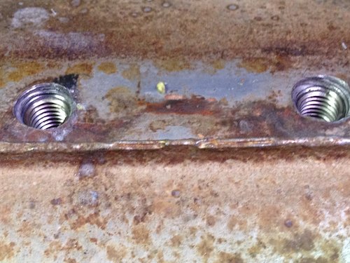

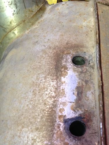

Fixed, but now I know why it broke and you may want to watch out too!
My flex pipe split due to the Heat Exchanger hanger bolts stripping out
resulting in the weight of the exchanger and muffler stressing the flex pipe.
It was hard to see this as the bolts on top of the exchanger were in place
and the amount of sag was not significant enough to notice.
The threaded holes in the exchanger are Aluminum, must have been
over torqued and eventually completely stripped out. Easy to fix with
Helicoil, see PIX's.
Now on to the Shocks.
ron
ron
- stripped.jpg (39.82 KiB) Viewed 9906 times
- helicoil.jpg (54.73 KiB) Viewed 9906 times
