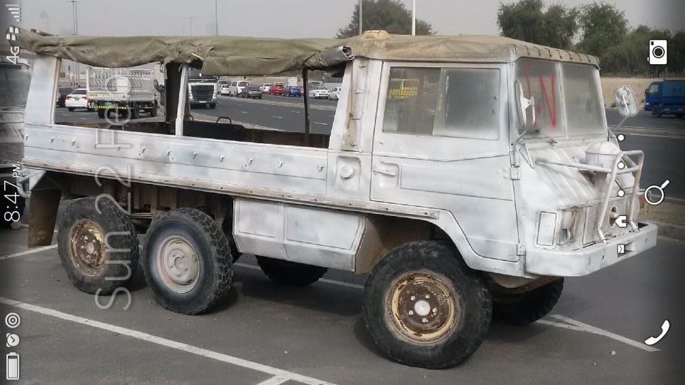

Hi. Just got my first Pinzgauer - 1984 712M.
It is decommissioned from the Oman Military. Hence the lovely paint job (desert tan underneath). It will not be legal to run military paint job here (in Dubai).
Lots of work to do, but first up will be get the missing bits to try and start her up. These will include batteries, distributor, #4 spark plug lead, fuel pipes to/from fuel pump, throttle linkage to rear carb, and hopefully not too much else. Other cosmetic items are missing or damaged as well.

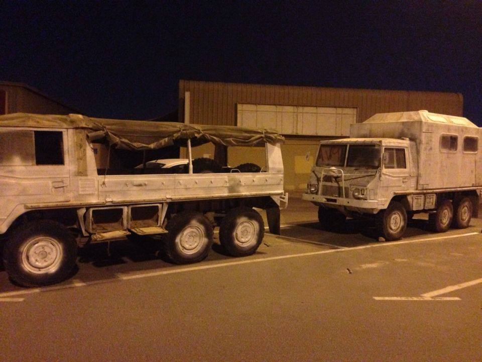

The workshop truck below belongs to a friend and his Dad. They are going to turn the workshop into a camper, early planned stage on layout though.
I seem to have some features the Swiss/Austrian models don't. As far as I can tell they include a long range tank, front snorkel/air cleaner, side vents for cab, drop side on front left portion of troop carrier (only 10 rear seats due to access point), cab door locks even though military model, split windscreen, brush bar (dented), Michelin X tyres as std.

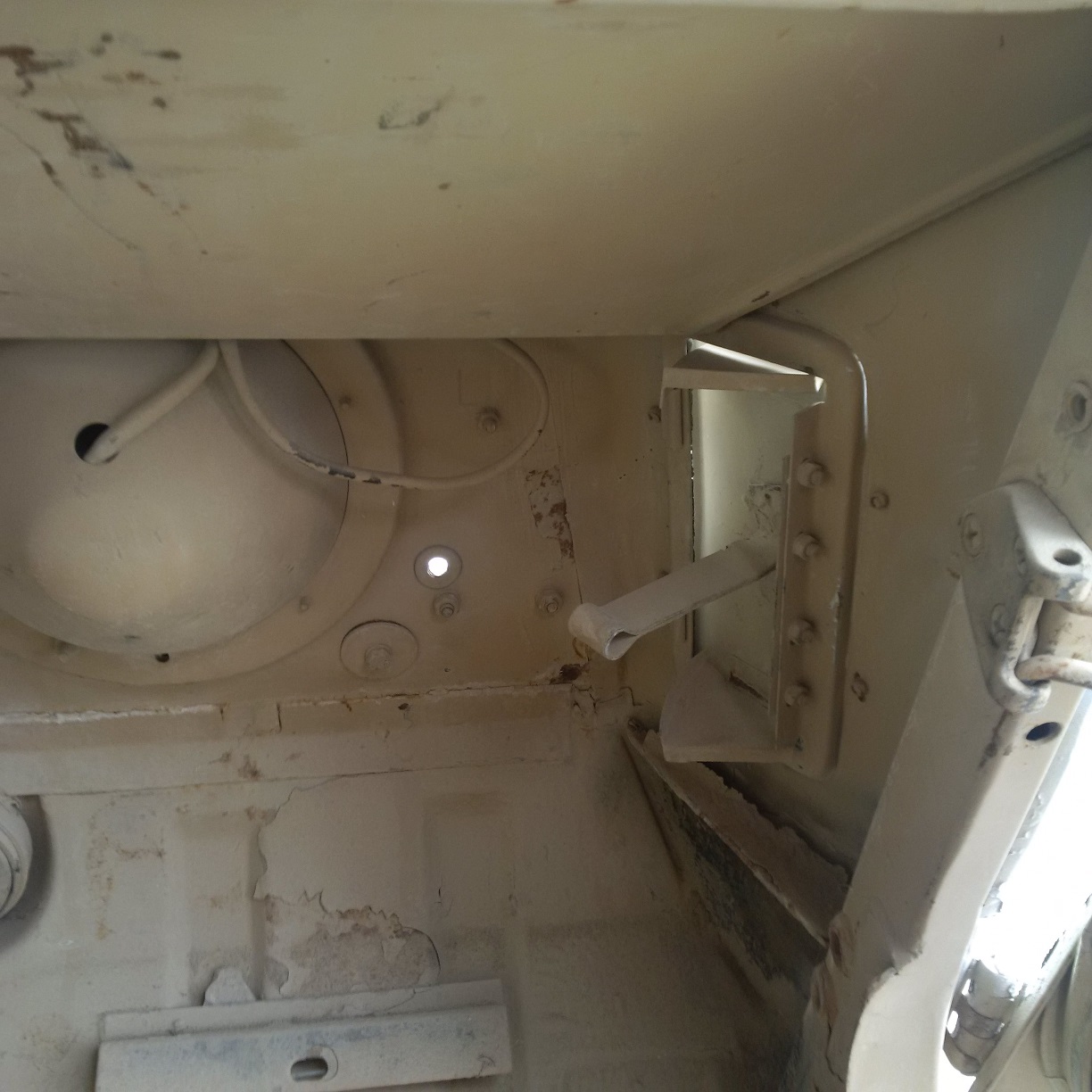

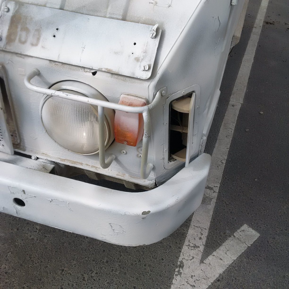

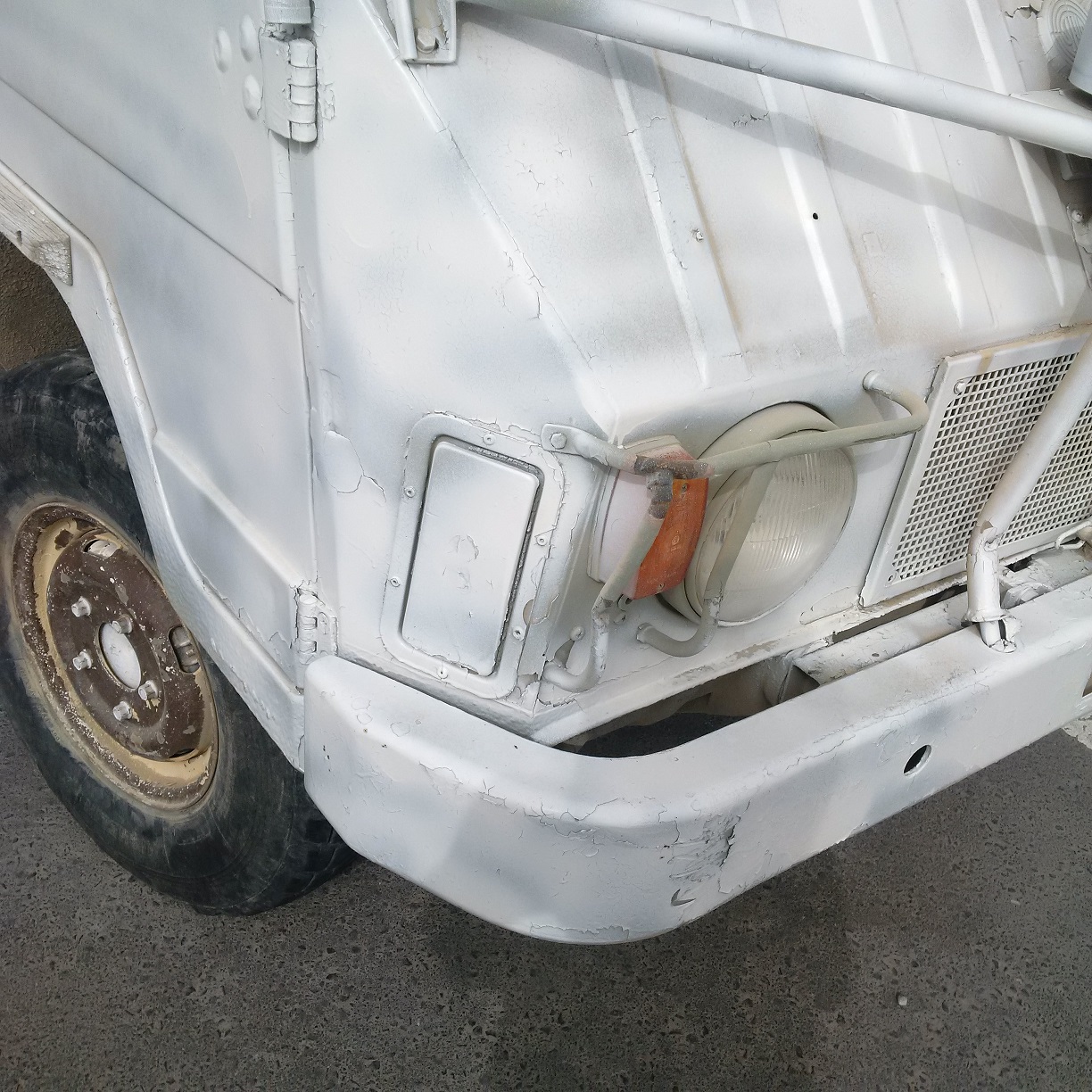

Here are some pics of the vent I found on the computer. I will be able to take some measurements on the weekend.
Note the internal shot shows the spring is missing on the RHS. Don't have a view of the internal LHS which does have the spring in place.
Hope these will help somewhat.
Mick

Perfect!
edit: looks like the left and right are not installed the same distance from the front edge (but could just be the angle or front end damage making it look that way)?
Re: New member with old 712M
drivers side is further back to allow clearance for the brake master cylinder.
So why not make them even?Andre wrote:drivers side is further back to allow clearance for the brake master cylinder.
Let's make mine even
