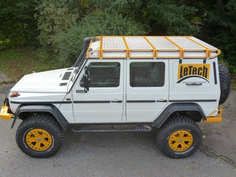

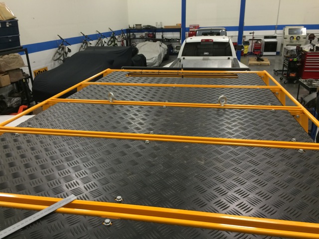

What does everyone think of this roof rack design (regardless of vehicle ie G or Pinz)?
Do you think the solid panels are an issue in any way?
Does the raw aluminum 5 bar reflect heat like white would?
I assume it may work like a Land Rover with the safari roof to keep the inside cooler? Painting them black seems nuts to me as the black would act like an oven IMO

Unless your rack is so small that you expect most of your cargo will extend past the edge, I'd recommend a rim to hold cargo on the rack:
One or two items, put them in a corner and just a strap, maybe two, is sufficient to hold them in place. Without a rim you would need a LOT more straps and might still not have your cargo secured. Similarly, the expanded steel that is on this rack makes a great place to hook to, in any location. And surprisingly, the small shadow that the expanded steel makes is a whole lot cooler than would be expected. YMMV.

Just some food for thought but I think the solid aluminum might give a bit of lift at highway speed like a wing or catch a gust of wind like a sail at the very least it will hold water that might pool on it with your gear trapping it in. I think a grating or expanded metal would let both air and water flow through eliminating any of those problem even if they may be just slight issues.

I believe you're exactly right- the polished aluminum will reflect light and heat, while black will absorb it and radiate it later. Both would shade the actual roof. The water issue is a good point- maybe perforated aluminum would have been a better choice? At least you'd get 75% shade and allow water through.

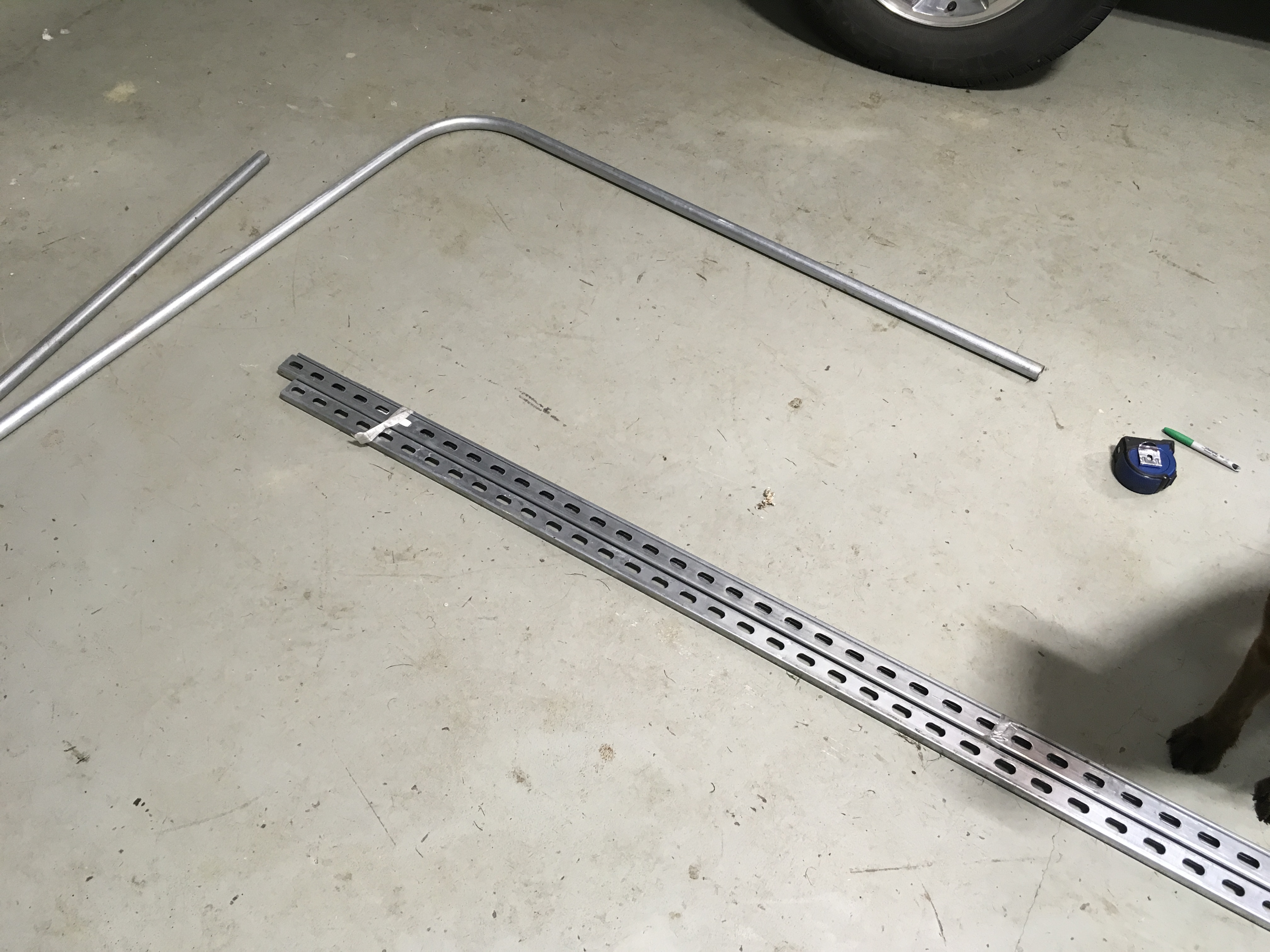

Laying out material for light weight roof rack that is very easy to remove when not in use. Machines a piece of stock to fit inside conduit prior to welding. Unistrut will be used on the top.
- IMG_1308.JPG (2.07 MiB) Viewed 11095 times

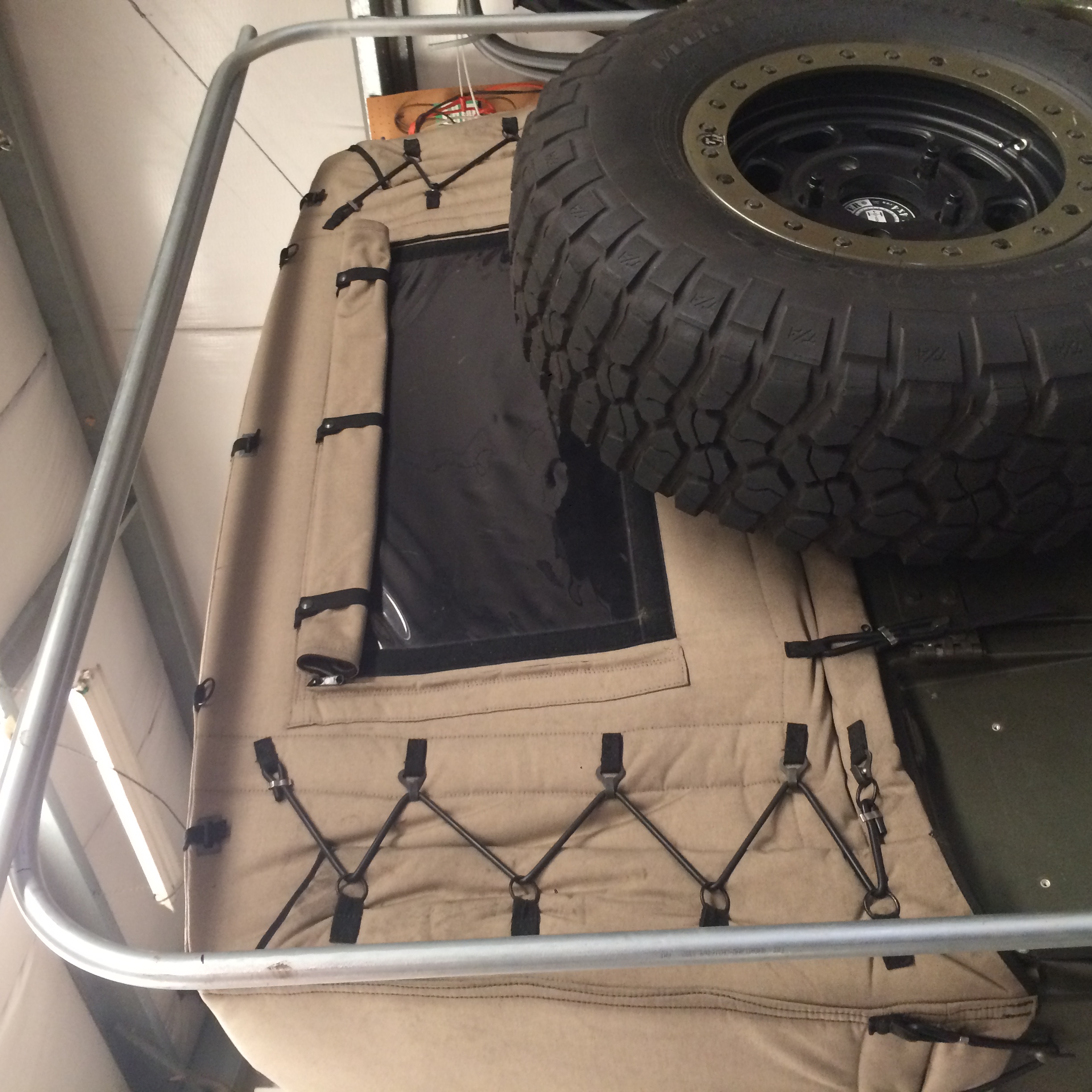

- IMG_0298.JPG (1.92 MiB) Viewed 11095 times

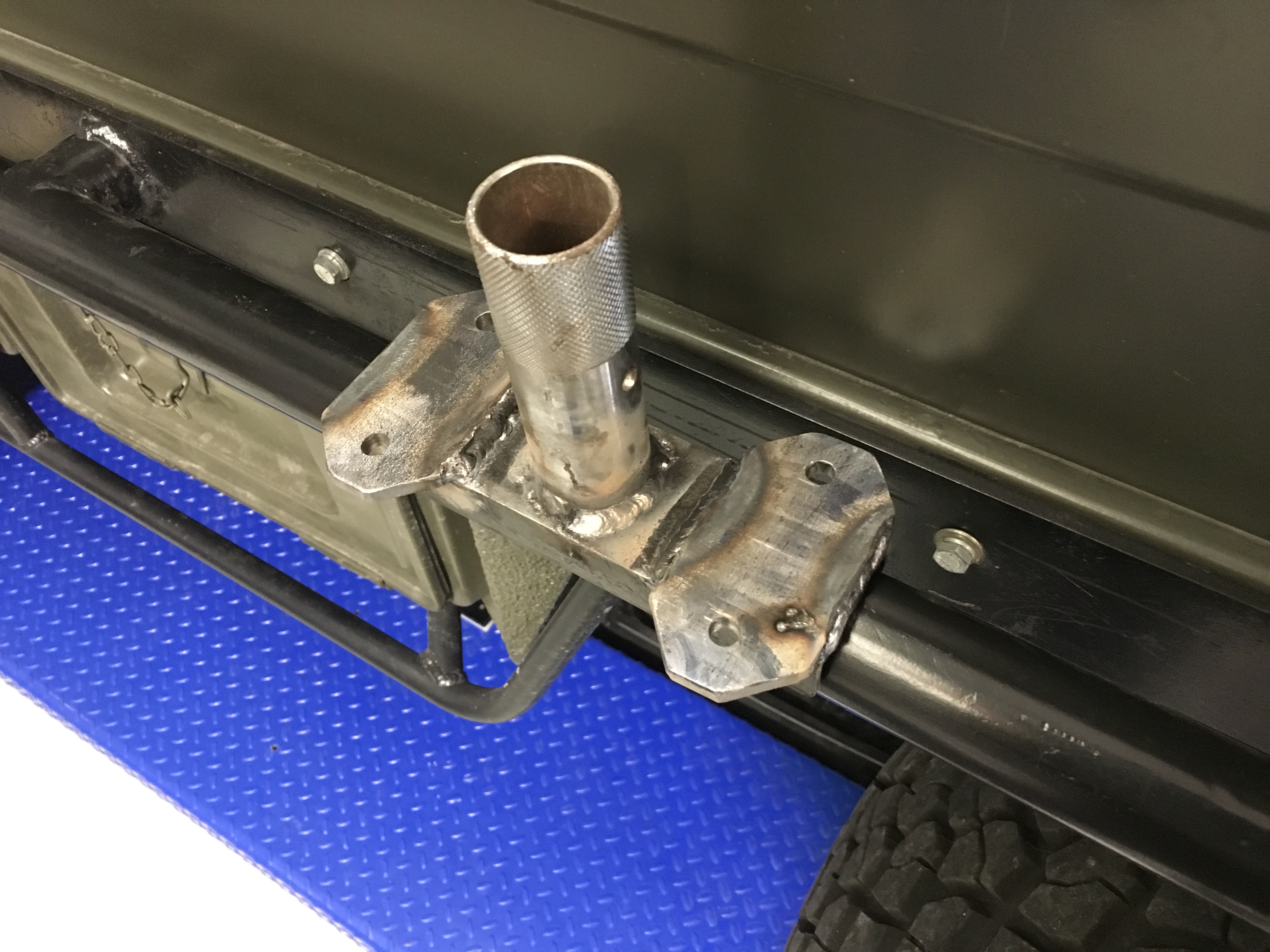

Hoops have not been cut in picture yet. The front brackets are made from scrap pieces I had laying around which have not been cleaned up yet.
- IMG_0302.JPG (1.98 MiB) Viewed 11094 times
- IMG_1310.JPG (1.13 MiB) Viewed 11094 times

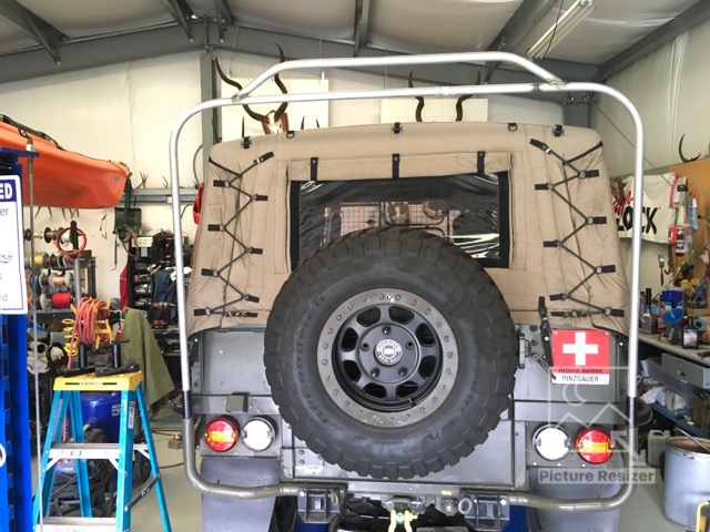

I've been pleased with mine. Its all aluminum so weighs less than 200lbs total so easy to remove if needed. The top is mostly covered in a series of buckets between the cross members. Down the center is two runs of aluminum square tubing. One carries antenna cables and the other carries power to lights.
Here's a photo from above and a few from the sides. There's more photos at http://facebook.com/sarpinz if you're interested. There's also a few in another thread on the forum here.
Re: Roof rack opinions
Gadgetfreak,
Do you have a pic from the rear?
Here's a couple.
