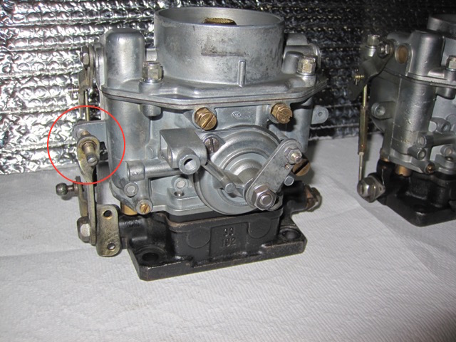

I think your carbs use the smaller idle speed adjustment screws (red circle). Both sizes were used for no apparent reason that I've found. And yes, there is one on each carb.

Here's a photo of the adjust screw on the front carb.

Okay, I see. Face palm!
I thought they were lower than that, on the plate that has the two holes...
Sounds like I will be upping the idle and balancing carbs today, or at least attempting...
