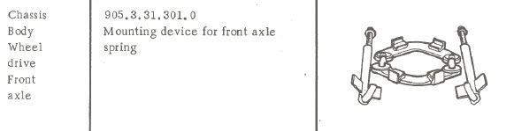

great photos. note the rotted cup and the tools needed to replace. Do not try to mcGyver
Re: Broken Front Spring Cup
Posted: Wed Apr 27, 2016 10:15 am
by undysworld
FWIW, I believe the spring compressor shown is a McGyver.
The factory tool had a two-piece flat end that the arms pull on, if I'm not mistaken. PC, can you confirm?
A McGyver is okay, provided it's stout enough for the job.
Posted: Wed Apr 27, 2016 11:45 am
undysworld wrote:FWIW, I believe the spring compressor shown is a McGyver.
In the repair manual it shows something similar but not quite the same so could be a copy someone made?
