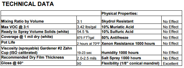

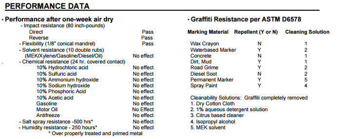

Andre and a painter are doing mine. They are scuffing the OD and then will be shooting with a commercial Martin Señor paint. Key for me was the salt spray rating, chemical resistance and abrasion rating. This paint will stand up to acid and brake fluid with no degradation.
Once body is painted it will come off and we will do underneath in the same paint but flat and then move on to undercarriage. Inside gets heat and noise reduction spray and then black bedliner (front and back).
Sounds like some blood awesome body armor paint. What kind, exactly, and what clearcoat from Martin Senour have such high salt spray, chemical, and abrasion resistance ratings?

nicholastanguma wrote: Sounds like some blood awesome body armor paint. What kind, exactly, and what clearcoat from Martin Senour have such high salt spray, chemical, and abrasion resistance ratings?
PRISM acrylic polyurethane single stage so no clear coat
It is part of their commercial product line
Then one of there Hardeners - discussed with the paint tech in Dallas
