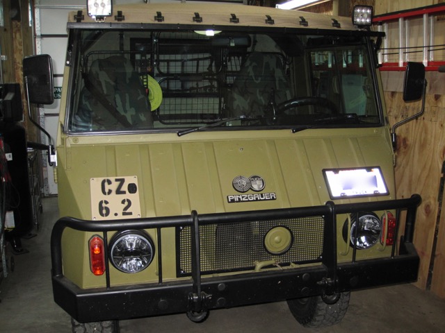

I have the Truck-Lite 7" on my Pinz. They produce a strong very white light.
10-31-13 01-40 PM.jpg (91.94 KiB) Viewed 3750 times
One possible drawback is that during driving sleet or snow, the headlights tend to accumulate a coating which blocks the beam because they don't produce enough heat like regular bulbs. Truck-Lite recently announced a new version of this bulb with a heated lens but they are quite a bit pricier.
