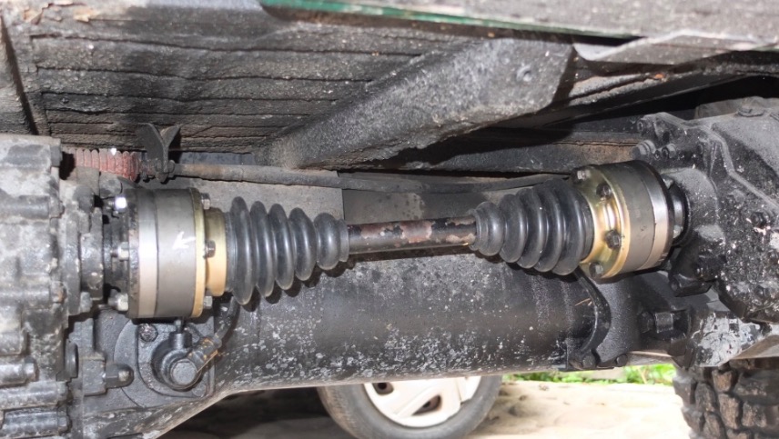

Bought a 1973 PINZGAUER 710M in Colorado and imported it into Mexico.
I have made some modifications that I plan to show off: one at a time.
DOUBLE CARDAN SHAFT.( U axle )
We all know: Pinzgauer are noisy. My guess: Some of it is caused by the Cardan shaft being that short and the driving and driven flanges not being aligned, you end up with a jerky rotation that translates into gear noise.
I switched the Cardan axle for a VW constant velocity axle. -I am not claiming that I am the first one to do it-.
2- type 2 (100mm) CV joints VW Bus sets (VW Thing´s cv joints might be better, German made is always better). You will need longer bolts, washers and safety nuts.
2- ½ inches spacers – donut like shape, to make up for shaft length-
1-VW Thing axle
It is an easy modification.( machine shop needed)
CV joints and flanges almost fit, you have to open up a notch the holes in the flanges, fabricate the spacers and grind out the shoulders in the axle, so you can fit the CV joints on the axle´s splines and fit the snap rings (with the right axle and cv joints combination, you can skip this step)
Keep the U axle in the truck (just in case)
According to The Samba Forum: it will handle the power, if not? I´ll rather break an axle than the gearbox.
So far: the noise level is lower, nicer sound - less jerky- and feels lighter on acceleration.

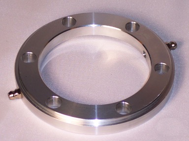

I would have liked to see pics of the spacers you made and what machining you did to the ends of the axle.
Re: CV AXLE
I did not take any photos before assembling the axle.
I built it with parts locally available, the axle is used and is not a perfect match to the vw bus cv joint, I just grinded off the small shoulders next to the splines to the axle´s diameter – the cv joint did not fit between the snap ring and the shoulder - , if you buy the cv axle set – see link – you don´t need to modify the axle.
http://www.thethingshop.com/C_V-AXLE-SE ... 1CV%2DSET/
As for the spacer they look like this photo, I did not add the grease port but I think is a great idea.

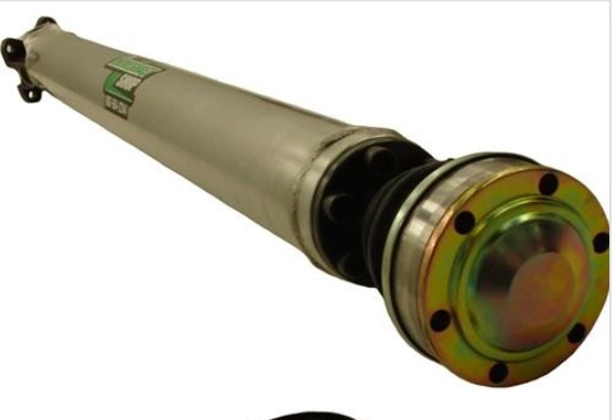

Here is an aftermarket Mustang prop shaft that use a CV JOINT.
http://www.driveshaftshop.com/domestic- ... nce-issues

YES, I DO. NO PROBLEMS SO FAR.
IT RUNS SMOTHER.
IF ANYONE DECIDES TO TRY IT, PLEASE, LET ME KNOW WHAT YOU THINK ABOUT IT.
