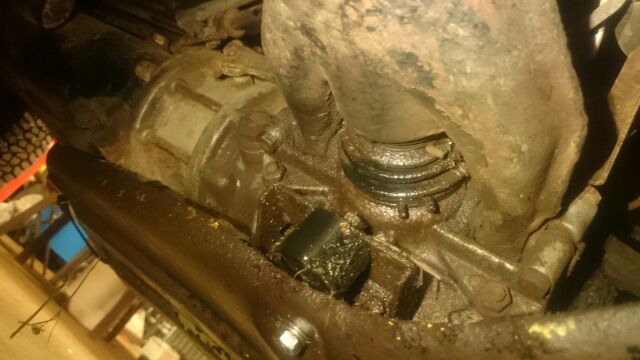

G'day, new here, where do you think my oil is leaking?

I have been having a look at the old Hafy and wondering if it's just the swing arm/drive shaft boot that's leaking, or will oil escape the diff lock shaft, or does it come from the swing arm pivots?
Either way I've been giving google translate a work out, along with an exploded parts book I found online, to try and locate all the correct stuff.
Apparently my 1966 Haf has "early" front drive shafts and the language barrier is a bit of a problem looking for CV boots!
Anyhoo I'll try posting a picture;)

Well, if you filled out your profile, people would be able to point you in the direction of suppliers who can provide the spares you require.
The most likely place is a split in the rubber boot, but they do also leak from the two "O" rings that are on the pivot point pins.
The rubber boots can be replaced with either split versions or whole ones which require you to take the drive shafts off in order to fit them.
You will probably find you need to get hold of the repair manual as well as the parts book so you can work out how to do things when you don't have access to this place or the other Haflinger forums.

The top picture showing the front wheel - the steering stop (the horn shaped thing) need to be turned round to point in the "2" o'clock position so it makes contact with the arm / stop on the wheel hub when you are on full lock.
The split gaiters work perfectly well if you put them on properly to clean mounting points. Any gaiter is going to leak if the pivot points allow movement in directions they are not supposed to move in!
Unless you have access to workshop type tools, lathes, milling machine etc. getting new pivot pins and the aluminium mountings would be the best way to go. Putting oversize pins in means you should ream the holes to make sure they are the correct size and parallel.
Lots of "PlusGas" or an equivalent penetrating fluid (Not WD40) on the mountings should allow you to take them apart. Just remember they control the "squareness! of the running gear - get it wrong and you Haflinger will "crab" and wear out tyres quickly...

As John said - the oil leak will be from the swing arm boot, if you look closely you will see it will have perished and cracked. Split boots work Ok but everything needs to be squeaky clean when you put them in and I advise sealant on all surfaces. They can be fiddly. I have replaced all four on my Haffie and they work well. The whole design is a bit silly - having the swing arms full of diff oil with the swing arm boots keeping it all in is ridiculous.
The other source of a leak - as John mentioned - are the swing arm fulcrums - another strange design as they use diff oil for lubrication rather than greased bushes or even rubber bushes where no lubrication would be required. The o rings either side of the diff end of the swing arm are supposed to keep the oil in but they are exposed to dirt and wear quickly. Mine all leak but I have replaced the original o rings with slightly thinker ones and the leaks have been reduced.
At the outer front, looks like you have the old CVs with a rubber boot - I have the later ones enclosed in a metal sphere. I rebuilt mine recently and had no issues doing so. With yours I guess you need to get new boots and repack the actual CV.

I wonder if it might be leaking from the drive shaft oil seal, but I don't think so. Usually that produces an oil trail at the bottom of the wheel hub / swivel pin / lower king pin area.
It order to replace the gaiter on the outboard universal joint (Manual calls it a Rezepa joint), you have to disconnect the brake pipe to the hub, undo and remove the top and bottom swivel pins and tehn pull the whole hub and rezepa joint from the drive shaft.
In fact there shouldn't be an awful lot of oil / grease coming from that part as the grease used is high melting point type stuff and so shouldn't turn to oil and leak out in great quantities - BUT - the real issue with split gaiters there is that it might allow dirt / stones / sticks to get into the universal joint which might cause the wheel to lockup, or just wear out quickly.
Unless the fulcrum point actually have movement in them - the repair manual state they will develop some (from new), but that it should not get worse quickly. I would live with that amount of oil weep!
Clean the existing oil leak areas, run the Haf, then check to see exactly where the oil leak is starting from. Oil has tendency to spread from the original leak point far and wide!

You can see that the CV boot is split (cracked) and it looks as if the marks are grease marks but in addition the oil seal in the swing arm where the drive shaft comes out and goes into the CV is most likely leaking as well.
In my limited experience with Haffies, if one bit of rubber has failed then the rest is on its way out or has failed so all will have to be replaced.
