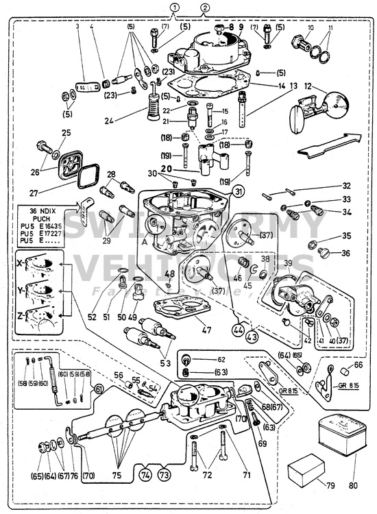

The chokes on the Pinz carbs are different then most. These chokes do not reduce the airflow thru the carb (like most carbs) but instead add fuel to the mixture. The plates I think you are referring to are the throttle plates. The choke is actually referred to as a starter valve and is mounted to one side of the carb. It is item #44 on the diagram:
The choke plates (#37) would be wet with gas because gas flows thru the starter valve before being added to the fuel/air mixture.

Funny thing was the front carb was missing part number 8 above, which is listed as "Protect Straine" on SAV website.
When I was cleaning out the rear carb I found the missing item. Luckily it got stuck on the emulsion tubes and didn't pass by the butterfly.

Is there a diagram which shows the correct clocking of the item 37 against the item 41. Obviously there are only 4 answers and only one of those is correct.
See how it is now on the rear carb :
I haven't see anywhere a diagram for this, including Jim's Goatwerks write up. My front carb had the larger trapezoidal slot at the top, rather than the kidney bean.
