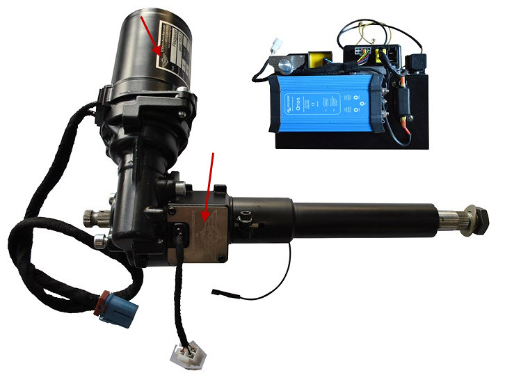

Here is part of the email I received:
only thing was it is 12v so you need a converterWe have a kit with replaces the upper part of your column it is 60 Amps and powerful enough.
Attached are pictures of the kit and the complete column.
I have also attached a manual for a Citroën Traction, the installation of this columns is almost similar.
The kit is 1250 and shipment 150 euros
With kind regards
Ruud
If it fails (steering motor or converter) then your steering just goes back to manual - no loss
Sad thing is if you zoom in on the link Vince provided you will see it is the same system!!

Here is the kit pic they sent me

That converter shown is a Victron Energy, Orion 24/12 70 Amp unit.
It can output to spec even with only 18V input -- a top of the line
product. The output is adjustable from 10v-15v (F set to 13.3V).
At 60A peak load you will be 30+Amps on the 24V side. Make sure your
alternator is up to snuff -- although the motor demand will obviously
vary considerably by road condition -- your arms can tell you that

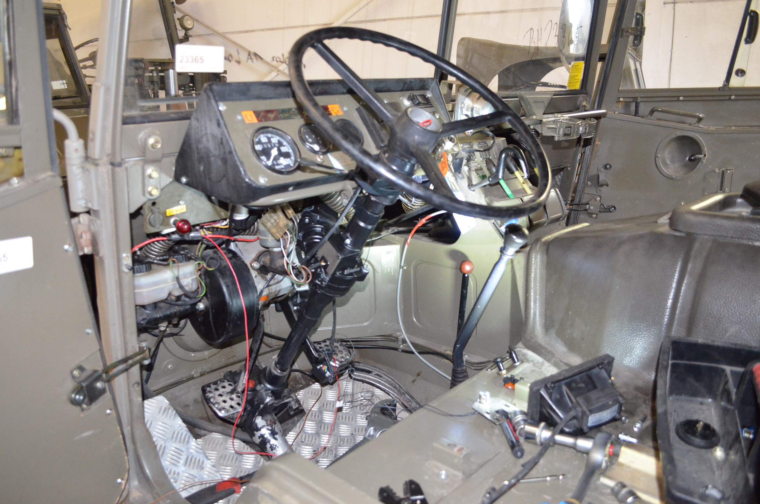

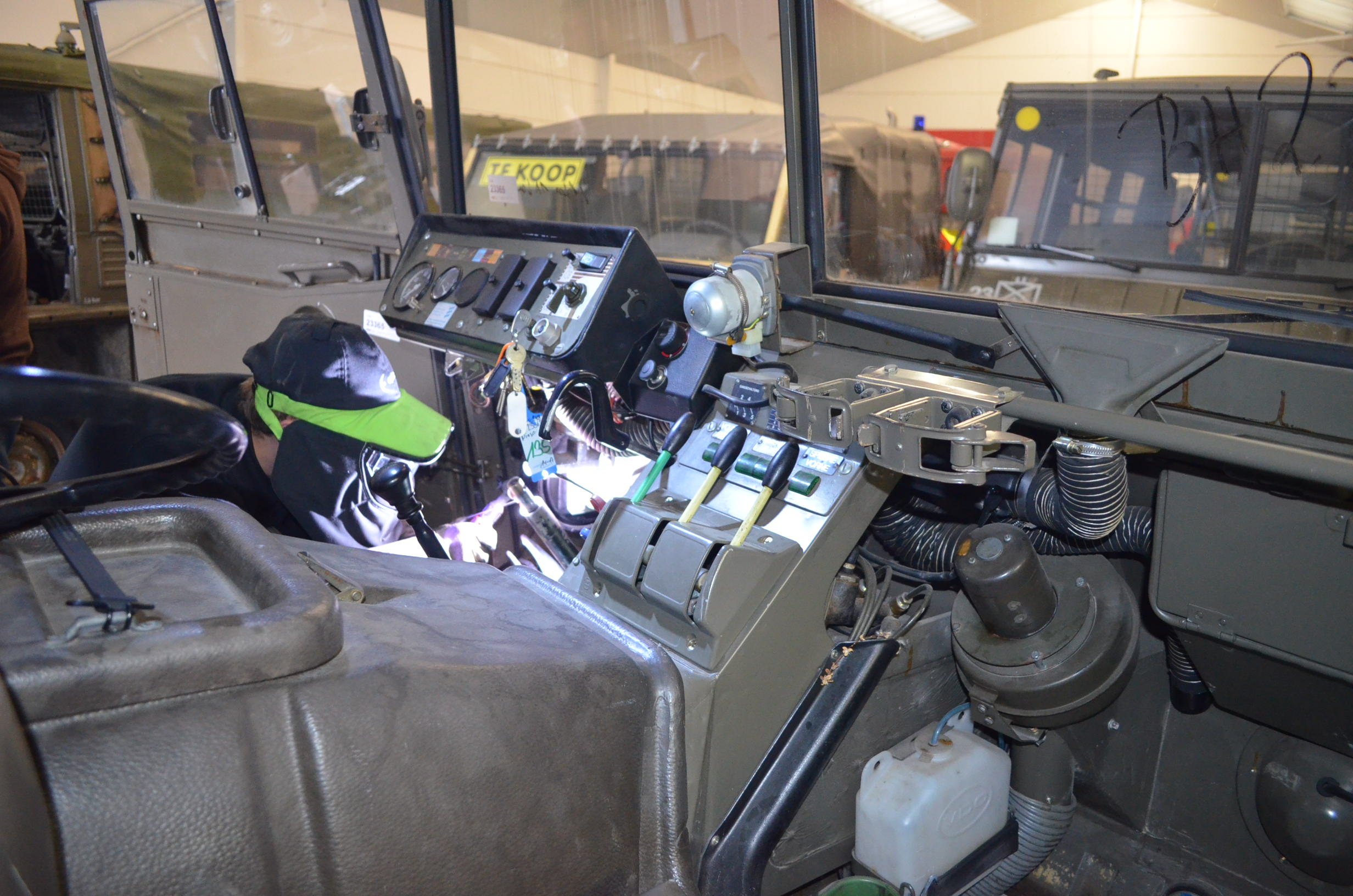

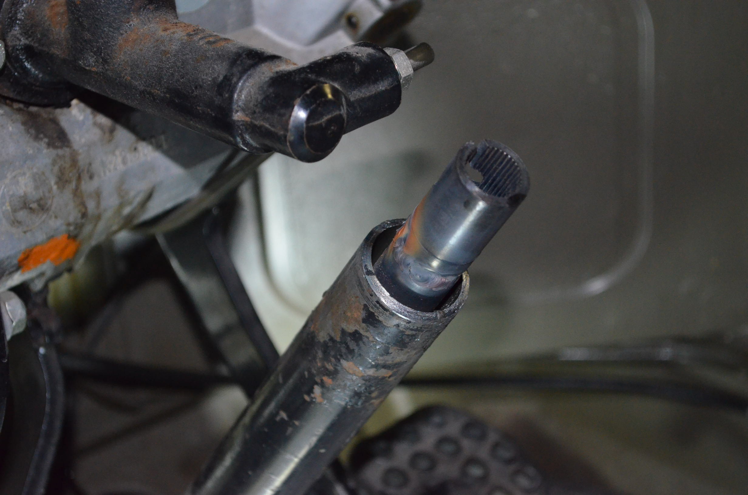

We actually had the engineers from the OEM at our warehouse in Belgium this morning installing the systems into 2 of our Pinzgauers. Installs completed, results are incredible. It made a statement with us as we placed a purchase order on the spot for 10 units. When I have some time I will do a proper write up and give you our observations. It will go to market FOR OFF ROAD USE just under 2K. It has been approved for road use in Europe, however my company is not willing to handle that process in the United States, so at this point it will be sold for OFF ROAD USE ONLY. Installs were so simple, 2 trucks completed in 4 hours with 2 engineers. They actually cut and tig welded the columns in the truck. Install at our shop will run in the $500 range if your truck is near Vallejo, CA.

Can the knee guard still be installed without having to modify it?
Will there be a possibility of selling pre-fab parts (steering shaft/column) and shipping the assembly for bolt-in installation?

Re: Electric steering for 710/712s
Steering bolster fits at the top but is about 1.5" off at the bottom where it clamps to the tube. A spacer will have to be used.....rather minor modification.
Power options will be up to the customer. Single tap off of 1 battery seems to be the norm over here in Europe....I am not a fan of that option personally. A 24-12 converter that can handle 40 Amps is an option. Or another option being used here in Europe is a 24-12 charger feeding a 12V auxiliary Gel Cel motorcycle battery.....

We will be happy to have a customer send in there box, we mod it up and send it back. Same box received, same box sent back. We will be filming and have in install booklet and the install is very straight forward. The technical aspect is someone that knows how to tig or mig weld professionally as people's life depends upon it. With the exception of the welding Jim Boy or Billy Bob would be able to handle the install.....and I've sometimes been quite amazed at the quality of weld Jim Bob can do as well.

I bought this kit for a much lower price but have been hesitent to install it. First the adapter that has to be welded on to the steering shaft is pretty high carbon and I worry about the weld cracking. Second the shaft in the steering motor is tiny. I think it is supposed to be good for 300 mm. I finally decided that it would require too much testing for me. I am glad somebody else has taken it on. So far I have had to rely on cortisone injections to the shoulder and that gets old.
