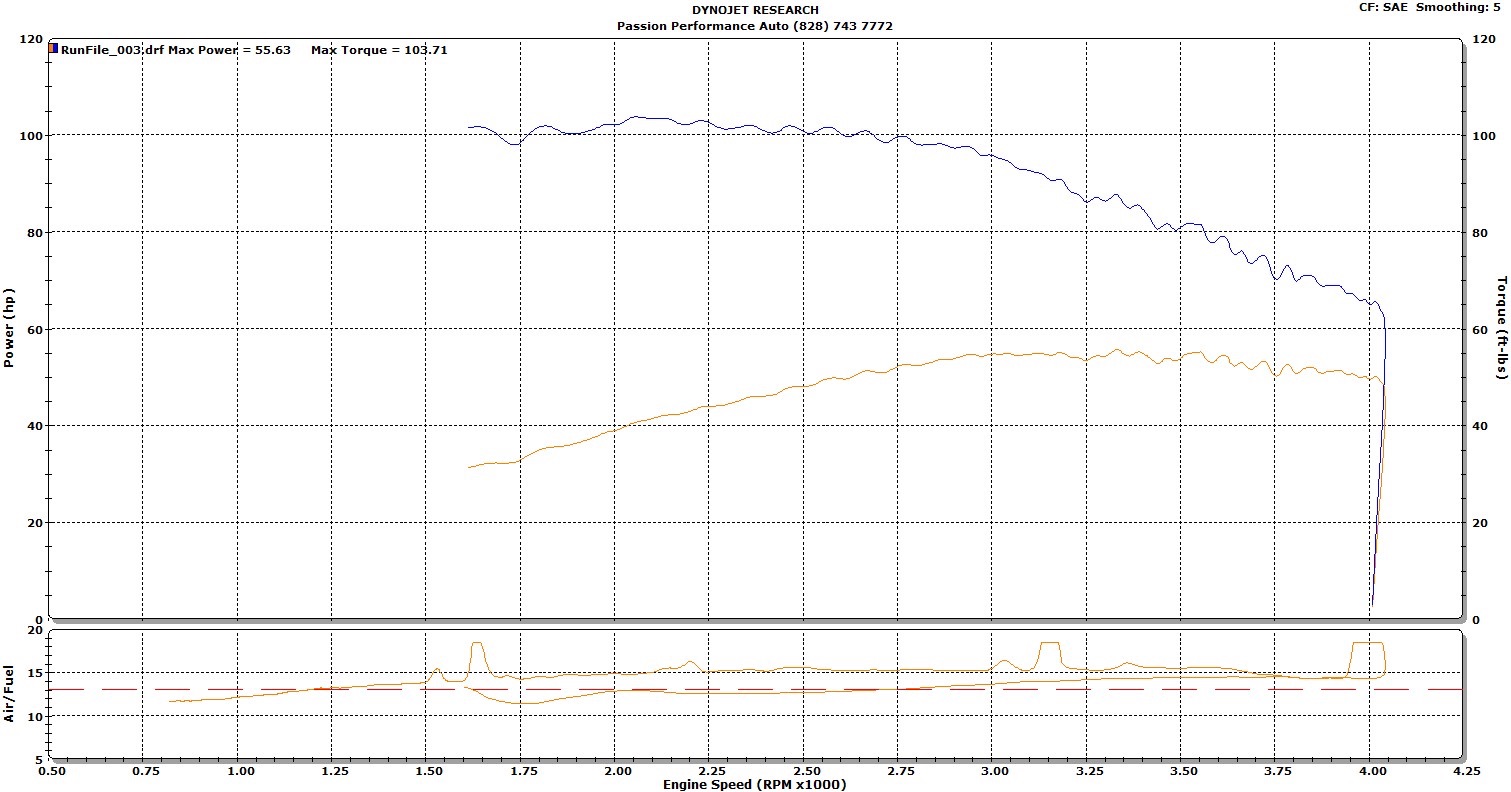

I was surprised to find a nice Dyno set up just a few minutes from my house. I ran the Pinz to get a baseline for my smell reduction campaigne.
i found out the mixture is pretty good except at idle, where it is rich.
The Dyno and the people who run it are geared towards high performance. The Pinz is on the low end of what can be measured. So far I have only run against roller momentum which I think under ,erasures HP.
Trying to attach pictures

The Dyno is really for "super cars". It is rated at 2,000 HP. It has rollers for the front and back wheels for cars with stability control. The front and back rollers can be connected with a clutch. I just used the rear wheels and the front did not turn. If you run a car with stability control and the front tires do not turn just right the traction control will back off power and apply the brakes.
Take the HP numbers with a grain of salt. The eddy brake was never engaged. The only resistance I pushed against was the angular momentum of the drum. The machine calculates torque and power based upon how fast the angular momentum changes. What is not clear is how the power to spin up the truck's shafts, gears, axles, wheels and tires is accounted for. My guess is that they are not. I could see losing maybe 10% in the gear train and maybe another 5% at the tire/roller interface, but not 40%.
If you look closely at the fuel mixture one you will see it is a double line. One line is running the drums up and the other is the drum driving the engine with the throttle plate closed. There are a couple of spots where the mixture goes real lean which I do not understand.
I thought the stench was over rich on trailing throttle, but that does not seem to be the case. Now I suspect that it is a matter of the exhaust valve opening before combustion is finished when engine braking. When you get a vacuum in the intake manifold it takes like 10 degrees more of crank angle to burn the mixture, at least according to what I read.
Does anybody know if there is a distributor that fits that has vacuum advance?
Does anybody have a exhaust gas analyzer ( HC, CO, and NOx) to lend or rent?

Got the raw data from the tuner and it looks a bit different. I see some real lean spots when engine braking. They are lean enough where ignition would be problematic.
All the lean readings have the same value of 18.4 grams of air per gram of fuel. I think I am bumping the edge of the A to D converter so the real values are yet leaner (but see below).
Alternatively, the apparent lean mixture spots might actually be artifacts of a misfire. The machine is supposed to measure air fuel ratio but I would not be surprised it goes wacky on misfire.

Just a thought.
Possible lean conditions due to leaks in exhaust system not great enough to cause audible backfiring however great enough to influence sniffer?

Well now I don't feel so bad. When I had my 710M on the dyno it came up with 58 or 59 hp at the rear wheels. That's with a 2.6l engine (92mm X 92mm), high compression pistons (relatively speaking), Beck-LaGuardia EFI, and a stock cam. Unfortunately their printer was down that day so I didn't get the final graphs.
