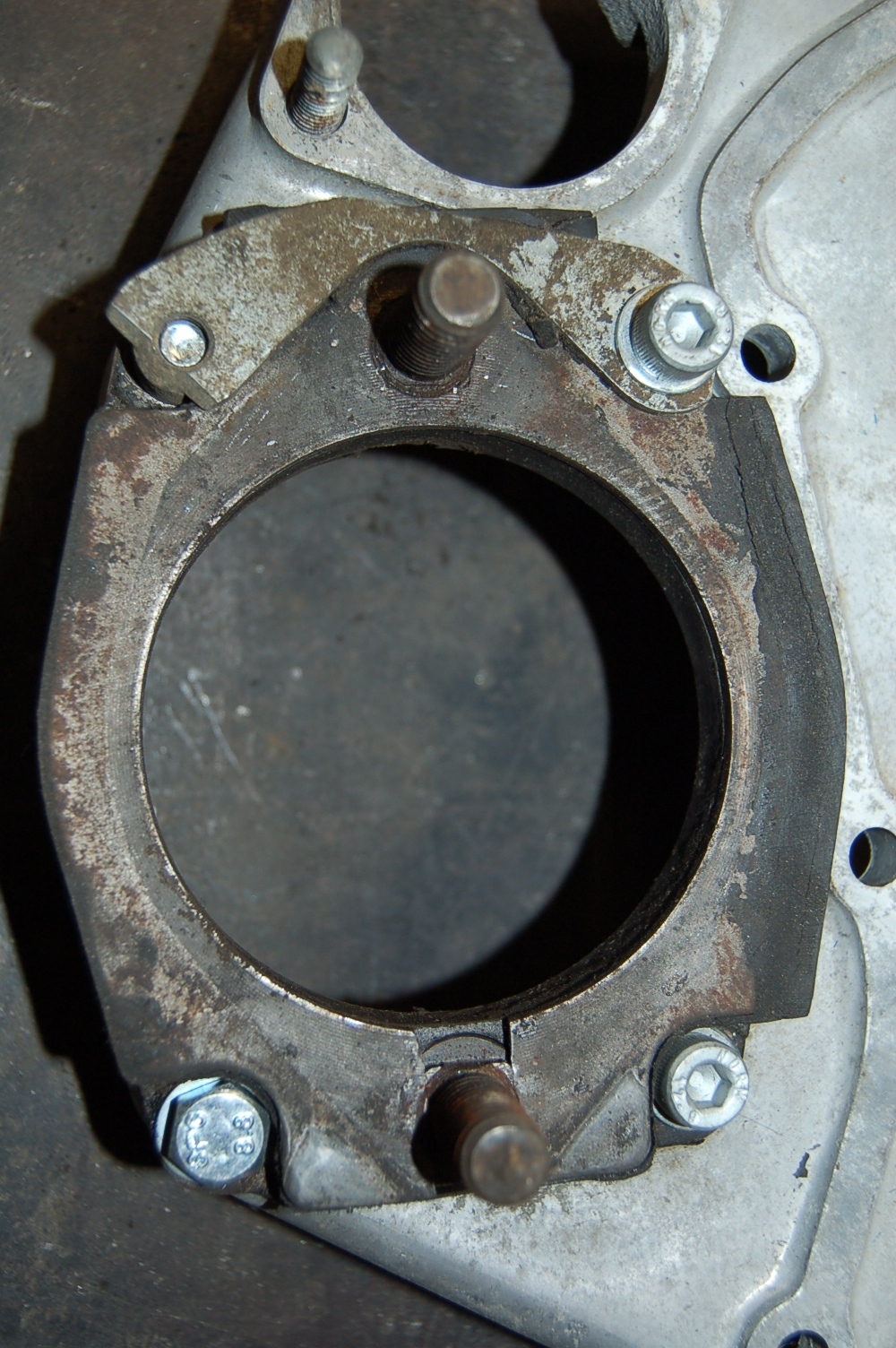

Re: Loose Starter
Posted: Tue Oct 13, 2015 11:19 am
by ExpeditionImports
Not an uncommon problem but not as bad as it use to be. Have seen a couple trucks which looked to have been serviced and for some reason the little metal brace/keeper was not reinstalled.
