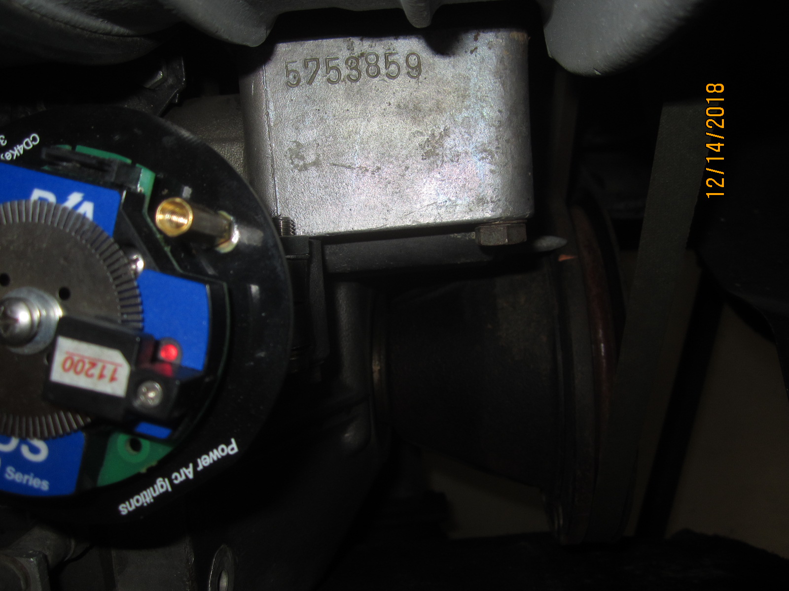

I have used a timing light powered from a seperate 12V battery I keep on hand. Usually 3-5 degrees BTDC worked well for me. Now that I have the PinzSSI system, timing is set without the engine running per the instructions.

I have the SSI ignition, and lost the ability to use the timing gun. Therefore, I use the technique you described... advance until it knocks, the come down a little more...

I am confused. I thought the SSI was statically set at TDC, red light on, and the SSI module did the rest. No need to adjust anything else. Am I missing something?

it is, but you can advance a little past TDC and not find yourself in a ping state. i found it idled and ran better

I have it stated in the instructions that the timing can be advanced, just use common sense. By setting the timing at TDC, the curve advance follows the factory recommendation as close as possible. Advancing is OK, and is accomplished by rotating the module against the rotation of the timing disc (CCW), just like you would with a distributor, using the rotor as a reference direction. I set mine a few degrees advanced and it runs great.
