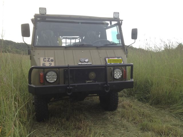

Posted: Tue Mar 26, 2013 6:43 pm
by mopar
I have pictures of the low and high beams posted. Light is very good nice and white. Here is what they look like on my pinz.
