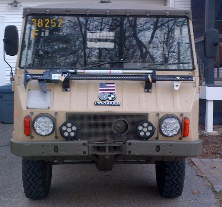

Re: LED Headlights
I have pictures of the low and high beams posted. Light is very good nice and white. Here is what they look like on my pinz.
- IMG-20130326-00166.jpg (47.32 KiB) Viewed 9387 times
- IMG-20130326-00165.jpg (63.87 KiB) Viewed 9387 times
