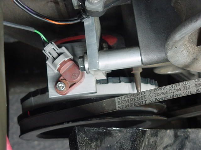

Jim LaGuardia
Posts: 1707
Location: San Bernardino Ca
Post by Jim LaGuardia »
Well, here is an affordable idea for you, not only will it work, it is cost effective. Make it like my trigger wheel and instead of teeth, have a ring of alluminum or steel cut to form an extention to the rear of the crank pulley, machine the belt groove into the ring and then align and drill , tap , and bolt the ring to the pulley, around $175-$300 or less :twisted:

Post by EvanH »
Here is the toothed wheel I have:
I found it at a pick 'n pull near where I live, on the ground. It was in the Ford boneyard, so unless it had a short career as a Frisbee I assume it is a Ford damper.
Some machining to get it to fit...I have not pulled the Pinz pulley to see what it would take to get them to play well together.
-Evan
