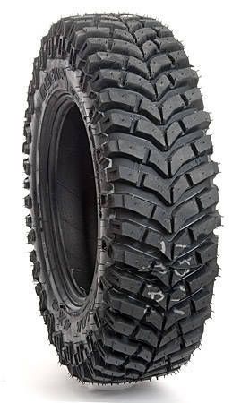

here is what the Mickey Thompson MTZ's look like

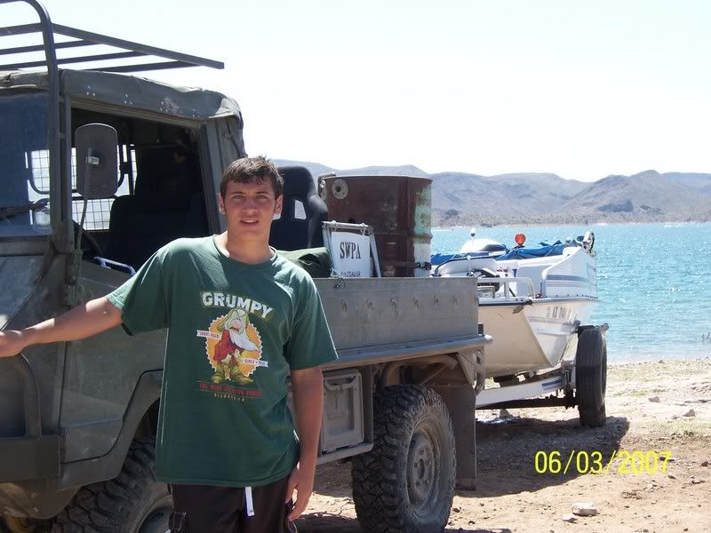

and what they look like on the truck these are 265/75 16's on original rims

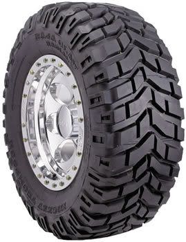

Not much difference in tires but the Mickey Baja MTZ have more contact with the road and should last longer than either of these. Ironically I had considered the Baja claws for my durango but settled on the 33" bfg mt's as the noise level on the claws is off the charts
pic of the mudzilla
pic of the baja claw
