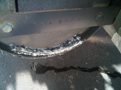

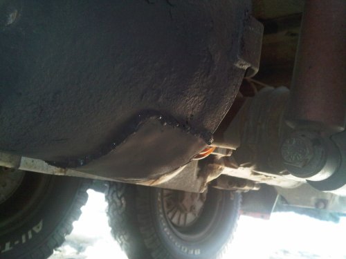

The backfire was getting nasty ! The liberals in the neighborhood thought I had now really lost it big time and was firing my AR-15 while passing by. "There goes the right-wing extremist nut job" sneered a few as I blasted my way through the town. What can I say, it's been a blast though.
The main exhaust tank has two rather large holes. We welded a steel plate to cover it that and tigged the edge side which was also shot.
Results - no backfire, increased power of the truck tremendously. Guys I'm not kidding, these types of exhaust leaks can really cause problems in power as well! I also tightned up the exhaust manifold nuts going into the cylinders. Found 2 were somewhat loose. Now I'm not sure if it's the nuts that caused the back fire or the holes in the exhaust ?

Hey Peresh, your repair looks nice and will stop the exhaust leak for now...but I highly suggest you start shopping for a new replacement to have in your garage when the exhaust finds its way out of the other weakend areas of the muffler which will undoubtedly happen. The muffler patches are like patches on your favorite old jeans yeah they hide the hole but just temporarily. I am sure there are some nice stainless steel replacements that would go right into the Pinz with some slight modifications..regards Larry
