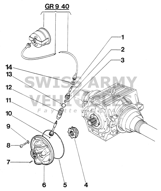

why would you need to take the front axle apart to work on the speedo. the speedo gear is located in the front witches hat. Take off the front nose and you can see everything you would need. I would how ever check to make sure the housing itself (which is accessible without any major disassembly) Might have to jack up truck and support so you can verify it is turning.

Your also going to have to take off steering linkage and front bumper support if I remember correctly. I did it when I was having trouble with my speedo, you should make sure it's screwed in all the way before u start taking stuff appart, it turned out on mine that all it had was that the cable was not going deep enough to catch the gear. Took cable out and seated it right at it hasn't failed again
