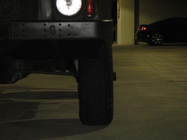

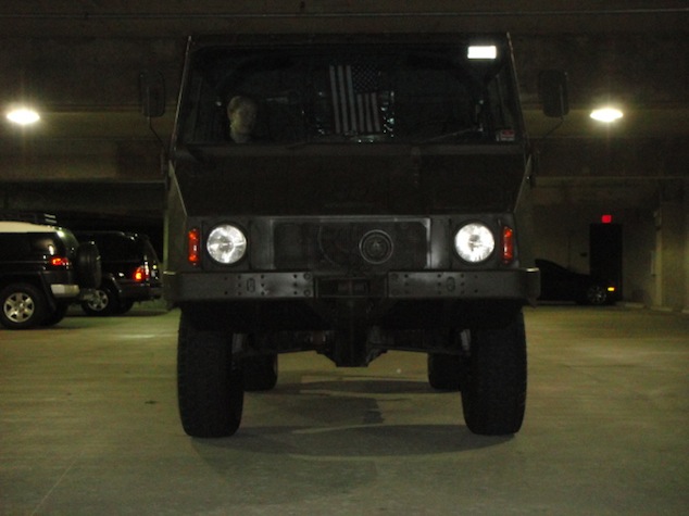

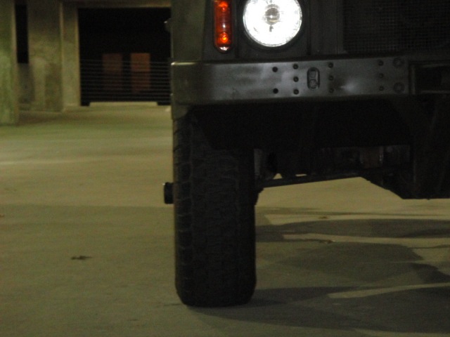

Both my front wheels are almost leveled. The top surfaces of the tires are slightly outward but its almost nothing. Both front schocks need to be changed, the left one is leaking.

Let me know what you guys think. Could not get more light for the pics.
Re: How much flex is normal on the front limiting straps?
In the last picture I can see that they do look like they are sagging a bit, nothing to worry about unless you bottom out when on the trails. That looks about the same as my 710, but since I don't go out every week and do the Rubicon I just don't worry about it. I still can put a full load of firewood up in it and it drives down the logging roads without any problems, so new springs are not on my list yet.
However, I did get new TD strength springs for the front of my 712W as the weight of the truck and box really made the springs sag; now the front tires lean out a little, probably about as much as I can see that your rear axle does. It did bottom out occasionally, so the springs were worth it.
