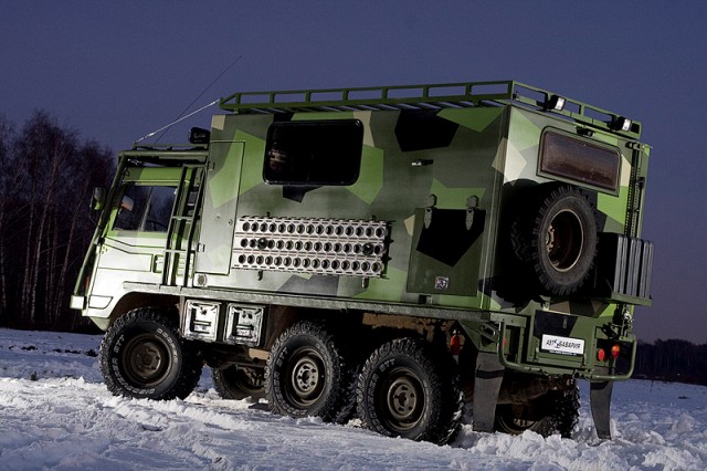

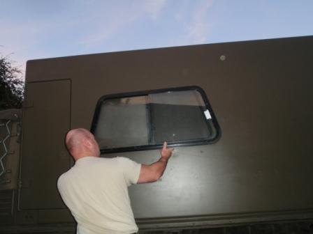

I am planning to start turning my Ambulance box into a usable camper that is comfortable for the family members to ride in the back. I am putting a RV bench seat that folds flat into a bed towards the front of the box and will be adding a rooftop vent and side windows that I recently purchased.
Does anyone have any experiance in cutting through the box? From what I can see and the little that I have read, it is a finberglass shell (outer) and liner (inner) with solid foam sandwiched in between. I am not aware of any wiring or structural support, at least on the sides. I plan to use a sawzaw to make my cuts. It looks to be about 1.5" thick.
The windows I plan to use are aluminum framed commercial marine grade sliders with screens. As you can see from the photos, I want to have the passengers see out of the box while sitting in the rear bench seat. They will also provide additional ventilation and light for the camper conversion.
Any pics, comments etc from anyone that has already modified their box would be greatly appreciated.
- Pinz window 2.JPG (19.2 KiB) Viewed 7149 times
- Pinz window.JPG (53.55 KiB) Viewed 7149 times
- I am using this Russian Pinzgauer as the inspiration for my build, I really like what they have done with their trucks.
- RU 712 LF.jpg (85.23 KiB) Viewed 7149 times

Do a search. Somebody a while back did a big post on cutting in windows and such into a amb top.

Re: AMB-S Box upgrades
E-mail sent...sorry for the delay.
For everyone else that is wondering about cutting windows into the box, its uber easy and I will be posting with pictures soon.....probably tomorrow.
Beautiful...where did you get the sand ladders?
bdelaporte
- Posts: 69
- Joined: Tue Dec 13, 2011 6:25 pm
- Location: Winter park, FL
The caption above the picture you are referring to states that this is a Russian truck that I found a picture of. I am using the deisgn ideas as a basis for the direction of my build. I wish it were, but it is not my truck.... mine is obvioulsy the other one that I am holding the window against.krick3tt wrote:Beautiful...where did you get the sand ladders?
The "sand ladders" are available at many Army navy Surplus stores. I saw a bunch in Tampa, FL a few weeks ago.

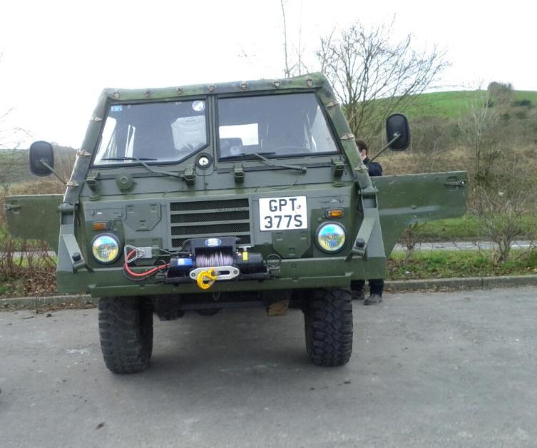

Yeah I should be getting this shortly
- Volvo.jpg (65.13 KiB) Viewed 6993 times
Mopar, you can't just post a picture and lets us drool about it. Oh, the mystery of what it is, please explain about the vehicle in your picture.
P.S., maybe a Volvo tanker killer.
David.

Yep Volvo TGB1111 tank Killerwudog wrote:Mopar, you can't just post a picture and lets us drool about it. Oh, the mystery of what it is, please explain about the vehicle in your picture.![]()
David.
