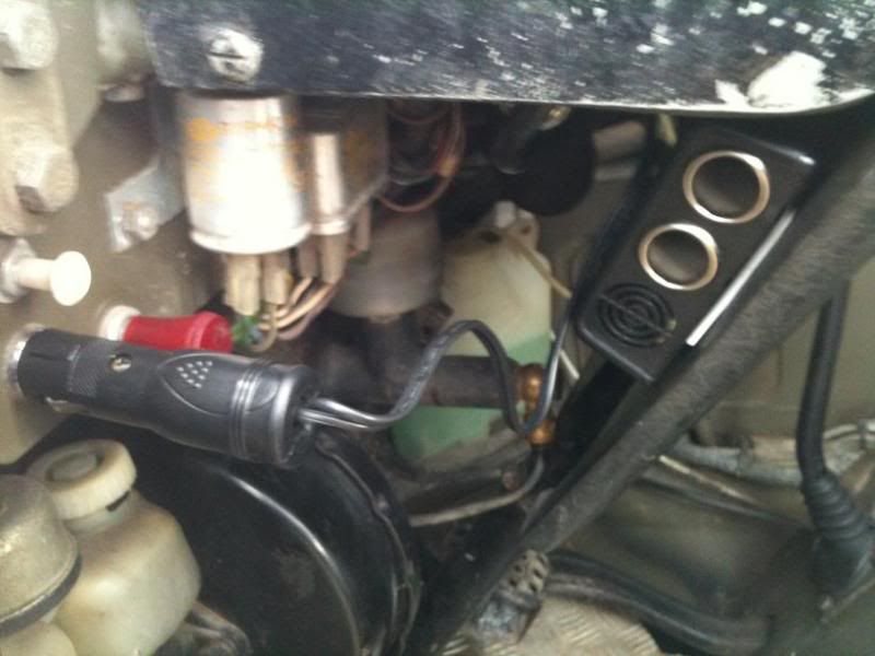

A co-worker gave me a hand held 24 volt spotlight I want to use in my Pinz. The problem is it has the wrong plug. Does anyone here know where I can get a plug that will fit into the socket on the lower left hand side of the dash? I believe this socket was intended for a convoy becon/light. Thanks.

In my quest to use the DIN plug beside the console for a GPS and phone charger, I found a 24v to 12v, 10A reducer. I am just looking for existing options out there where I don't have to strip and create a cable to fit the adapter SAV (SAV1065) sells. The red plastic bit can be removed for use in the smaller EURO DIN plug, or leave it in place for a standard cigarette plug. I have found it online for less than advertised in the link below.
What do you guys think?

In case anyone is interested, I got the 24v-12v converter in the picture above and installed it successfully in my Pinz. I ran my GPS off of it today without issues. I also plan on running my iPhone off of it. One thing to note, the smaller DIN connection on the plug doesn't insert as tightly as I expected, so I had to pry out the little metal prongs so that they grip the plug better. I hope to make this even tighter. Anyway, simple way to get 12V out of 24V without playing with wires and converters.

Re: Plug for spotlight
I ended up getting it from ebay.co.uk. It cost about $45 to my door. They seem readily available in the UK....Let me look around.
