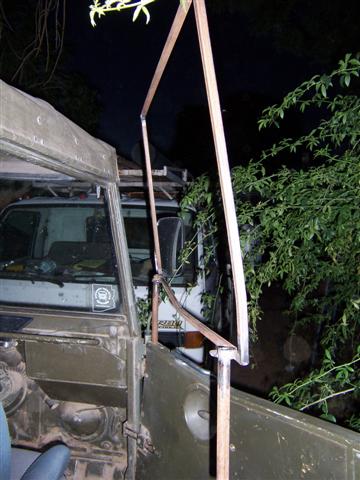

was hoping to get to the canvas/vinyl work this weekend but it did not happen. The frames are the easy part. there are a couple of ways to do it. for space concerns, although more flimsy a flat metal piece on top of the door and then the upper frame or for a more stiff design, rods down similar to existing tops attached to the upper frame.
The frames I use are the ones with the rods.
Personally I would like to see the frames break down and store into a piece of 2" plastic pipe that could be stored behind the seats. Anything else is pretty much worthless in my mind.
misc pinz 004 (Small).jpg (52.23 KiB) Viewed 7458 times
misc pinz 005 (Small).jpg (39.82 KiB) Viewed 7458 times
Re: Custom light weight (with zip in zip out windows) door t
Thanks for the photos. That is close to my design except that I have gussets in the corners for strength and rigidity and
I am using heavy canvas for the fabric with zip out plastic windows that will roll up and velcro to the top. Waiting for me to
make a table for my industrial sewing machine. I have the metal, just have to weld up the base.
Happy trails
