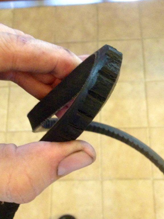

Replaced mine this weekend. Tried my air wrench first and it wouldn't even budge. Was eventually able to get the gun in there which made quick work of the whole affair. The belt was TOAST
- photo (2).jpg (55.35 KiB) Viewed 4316 times
