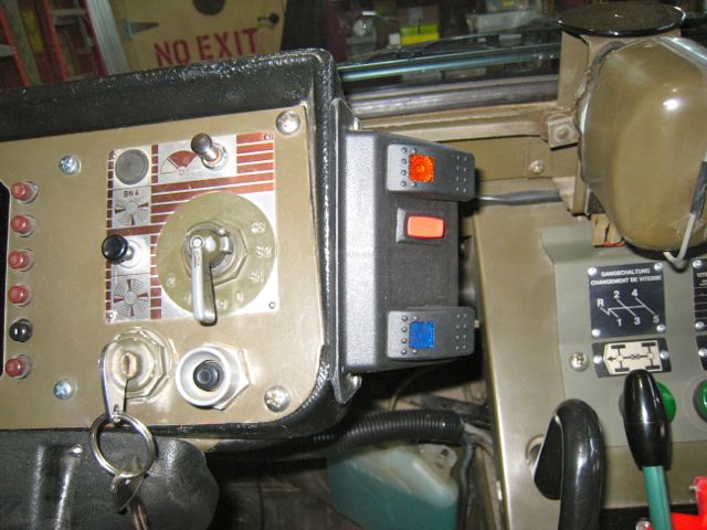

Here's what I did just to give you some ideas:
The switch panel is from Daystar, their number KJ71030, for a Jeep :? . http://www.daystarweb.com Available from Amazon. I used a Dremel tool to trim the panel to fit.
Daystar also sells the switches but only in 12 volt. The switches are made by Carling Technologies, (http://www.carlingtech.com) part of their Contura line, and are available in 24 volt from their distributors. I found one that was willing to sell me a handful of them (about $9 each) and they are really nice switches though obviously there are many brands and sources out there.
I fabbed together a light bar that works ok but I've seen nicer ones beyond by current welding abilities.
The LED lights draw much less than halogen/incandescent/etc. so I don't think you need a relay. I didn't use one and just picked up power from one of the circuit breakers.

Ed it looks like they will draw only about 2.25 amps (54 watts and 24 volts. it's two lamps that are 27 watts a piece.). Paul, your rig actually looks pretty nice. I like the switch set up and will try and mimic it. Do you find a need for a plate/shield under the lights to reduce glare? Or does your set up work fine?

John, I've had no problem with glare but I'd guess that would be different with each set of lights. Mine have a flat face so don't seem to project much light downwards or to the side.
Paul
