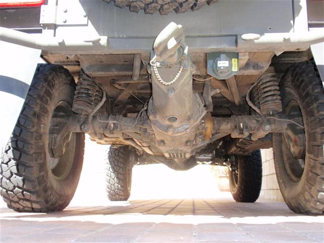

:idea: To make the axle "more parallel" to the ground simply load ~ a ton of concrete blocks in the back.
- aton.jpg (55.88 KiB) Viewed 3412 times
Re: Split boot replacement - looking for the dos and don't
In my case I would have had to put that in load in the front.
