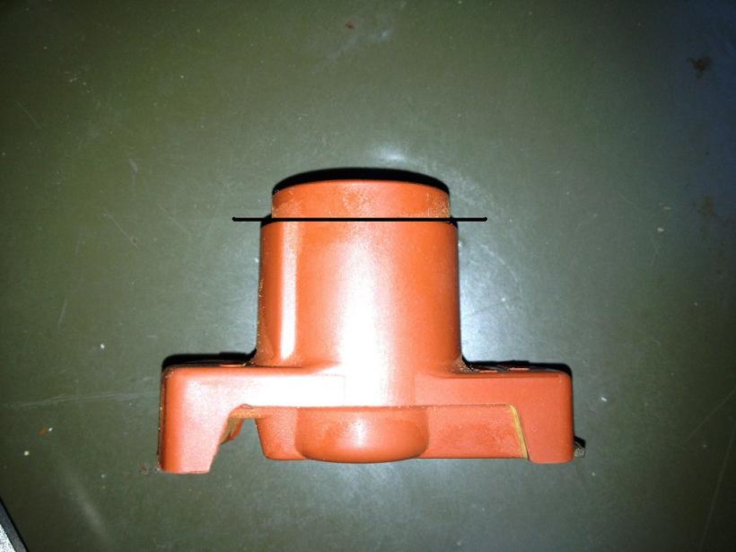

1)That rotor needs to be ground down. The rotor I replaced and the one I got from EI (I did it on belt sander), are ground down to the slight shoulder on the router. Remove to here...about an 1/8":

First inspect the cap center electrode(they can melt and stick), for the rotor, only remove half of the area to the step(1/8") to prevent breaking the cap or jamming the contact into it's bore.

does anyone know the correct overall height of the rotor? I have an aftermarket version without the should and don't know if it's been 'worked' on yet.

Winter Beater wrote:does anyone know the correct overall height of the rotor? I have an aftermarket version without the should and don't know if it's been 'worked' on yet.
You should be able to tell if it was worked on. Most (from my research) will use a belt sander to knock it down, and that is pretty obvious. Not as smooth as OE and the edges are not as rounded.
