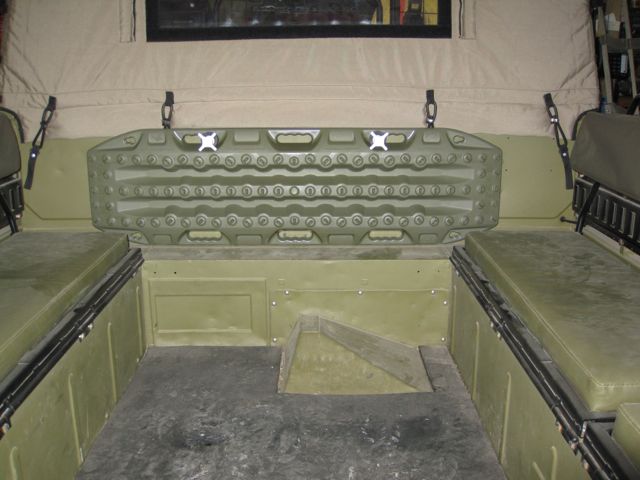

Anyway, for those of you also contemplating buying them, I found a nice way to mount them and thought I'd share:
The knobs with bolts and the rubber vibration insulators came from McMaster. The knobs are aluminum and have 10mm X 76mm threaded rods attached and fit right into the existing spots on the bulkhead where the 10mm bolts are stored for removing the brake drums. I plan to put some rubber anti-skid strips under the ramps just to keep any possible rattles quieted.

Very nice installation Paul

Very nice install
Thanks for sharing as that is. Great idea and method of mounting!

Really nice attention to detail. Do you have pictures of the rest of the truck?
