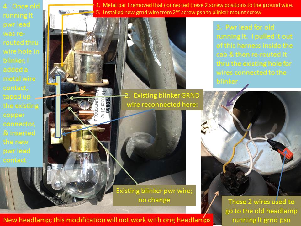

Update: marker lights conversion is done. Next up so I can get this thing registered: fix the license plate lights & replace the speedo with a MPG version.
I tried several configurations in order to use both existing blinker lights as both parking lights & blinkers by employing resistors and diodes in several locations. None worked in all situations (parking lights only; blinkers only; parking lights & blinkers at the same time - that's what I could not solve).
I ended up configuring 1 existing blinker light as a marker (parking) light and the 2nd remained a blinker only. I had to remove the metal bar that connects both blinker lights & is used as a ground for both bulbs (keeping it in place did not work). I re-installed the existing blinker ground lead directly to the screw hole that held the bar in place. Next, I re-routed the original blackout or dimmer headlight power lead (no longer needed after upgrading to more modern head lamps) to the 2nd blinker light (you must ensure the original power contact the bulb gets power from as a blinker is no longer touching that bulb). I ran a new grnd wire from the 2nd grnd screw position to the blinker mount screw. Worked like a champ in all situations.
I also tried to install a 50 ohm 10 watt resistor so the marker light was not as bright as the blinker light but it was too much resistance (the bulb barely lit at all).

Re: Street legal: front marker lights & replacement speedom
Pics of what you did??
HawaiianGauer
Posts: 52
Joined: Thu Jan 31, 2013 12:17 am
Location: Prescott, AZ
Post by HawaiianGauer »
See attached picture (just learned you can't upload pdf's or ppt's!)
No, this is not an elegant solution. The worst part is the physical connection between the running lt pwr lead I "borrowed" from the old headlamp harness & rerouted to power one of the 2 blinker bulbs: it is simply wedged in between the org blinker copper bar (which is taped up with elec tape) & the bottom of the bulb. No laughing!
Right now, simple goal was to appease Hawaii Recon requirements so I can register the damn thing with the limited time I have to mess with this & 2 other problem sets (speedo & no license plate lights).
We'll see how long it lasts. I've got a couple of better ideas to make the config perm. Also, I am concerned about how hot the marker/parking lt bulb gets (much hotter than the same bulb as a blinker). Not sure if it will last. Can probably solve that no problem with the right resistor, but I am ohm's law challenged....50 ohms was too much, the bulb barely lit.

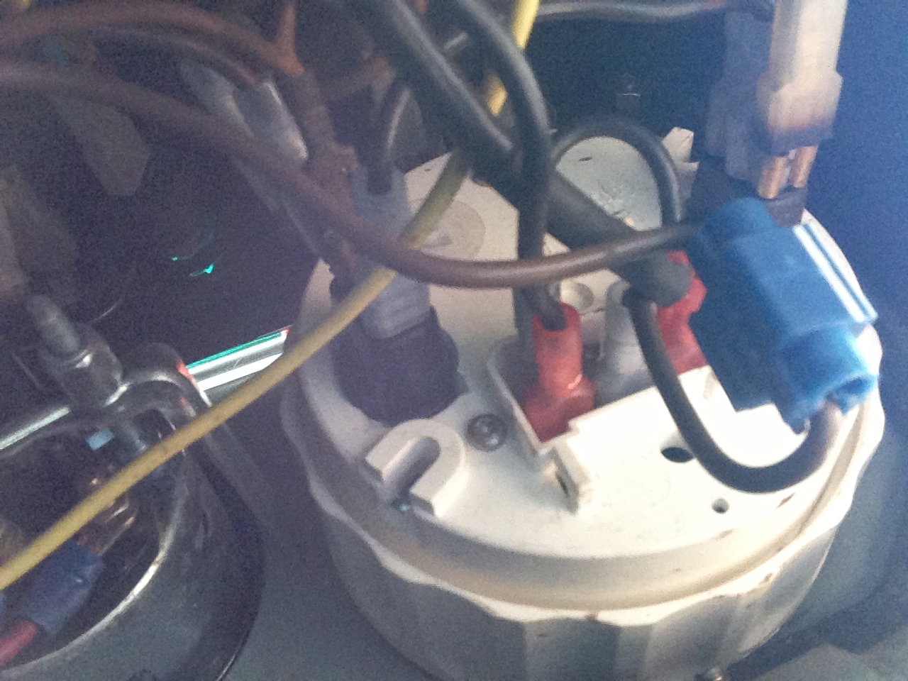

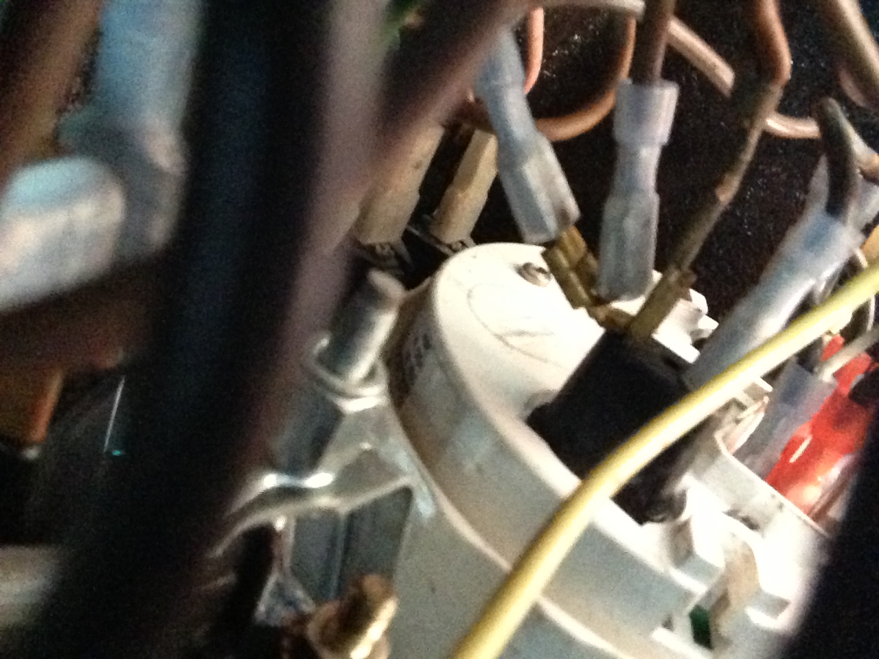

Update 2.
Met my first Hawaii-based Pinzgauer owner, SwissArmyToy Scott today! His reminder of grounding problems led to completing the license plate lights fix.
Started Speedo install. Removed old one, not difficult. Installed new VDO cable, not difficult. The 3 wires on the speedo cable, not difficult. But the rest of wiring - THAT'S gonna be a project! Had NO idea of the additional wiring, connectors, etc until I took some pictures behind the dash of Scott's today.
See attached to see what I mean. If ANYONE has some idiot-proof instructions on where the extra bunches of wires go, plugs that it didn't come with but apparently I need, I'd appreciate the guidance!!!!!!!!!!!! Otherwise, I suspect tomorrow is going to be a looooooooonnng day.

landy
Posts: 105
Joined: Fri Sep 03, 2004 10:48 am
Location: Albuquerque, NM
Post by landy »
I bought my VDO speedo from SAV, which came with some ok wiring instructions. If you don't have those, I can provide them to you as they will help. However, the instructions don't say where to get the switched-on 24 volt power supply from. I haven't finished wiring mine, so haven't determined the best source for that. Mine uses circuit breakers, so there's likely a source there I can use, but it's a pain to access without removing the breaker panel.
Let me know if you'd like the wiring instructions that came with my speedo.
Then 50 ohm is too much; try 25 ohms (or two of the 50 ohm resistors in parallel). This will brighten the bulb. You may need to go down to 10 ohms. Any value that gives you the brightness you desire will work; even down to zero ohms (a straight wire to the bulb).
You can also change the bulb for the running lights to be a lower wattage, such as a #301 (McMaster Carr # 9527T053) for a dimmer brightness.
