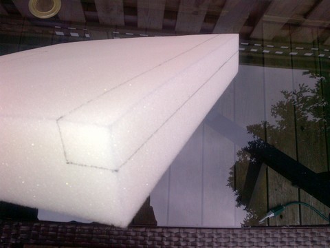

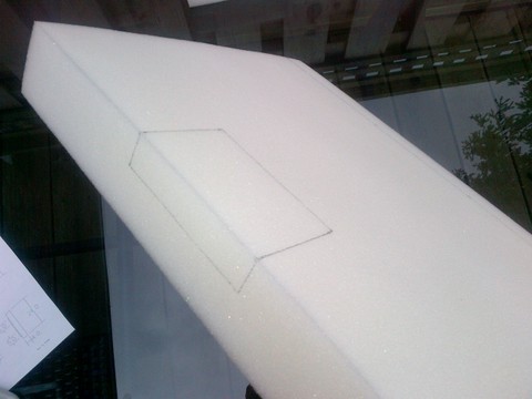

Found a great foam place and had them cut some marine grade high density foam as per drawing file.
I then used an electric knife to do the cut-outs (electric knife is only way to do this - super clean lines)!
Now just waiting for the marine vinyl to arrive.

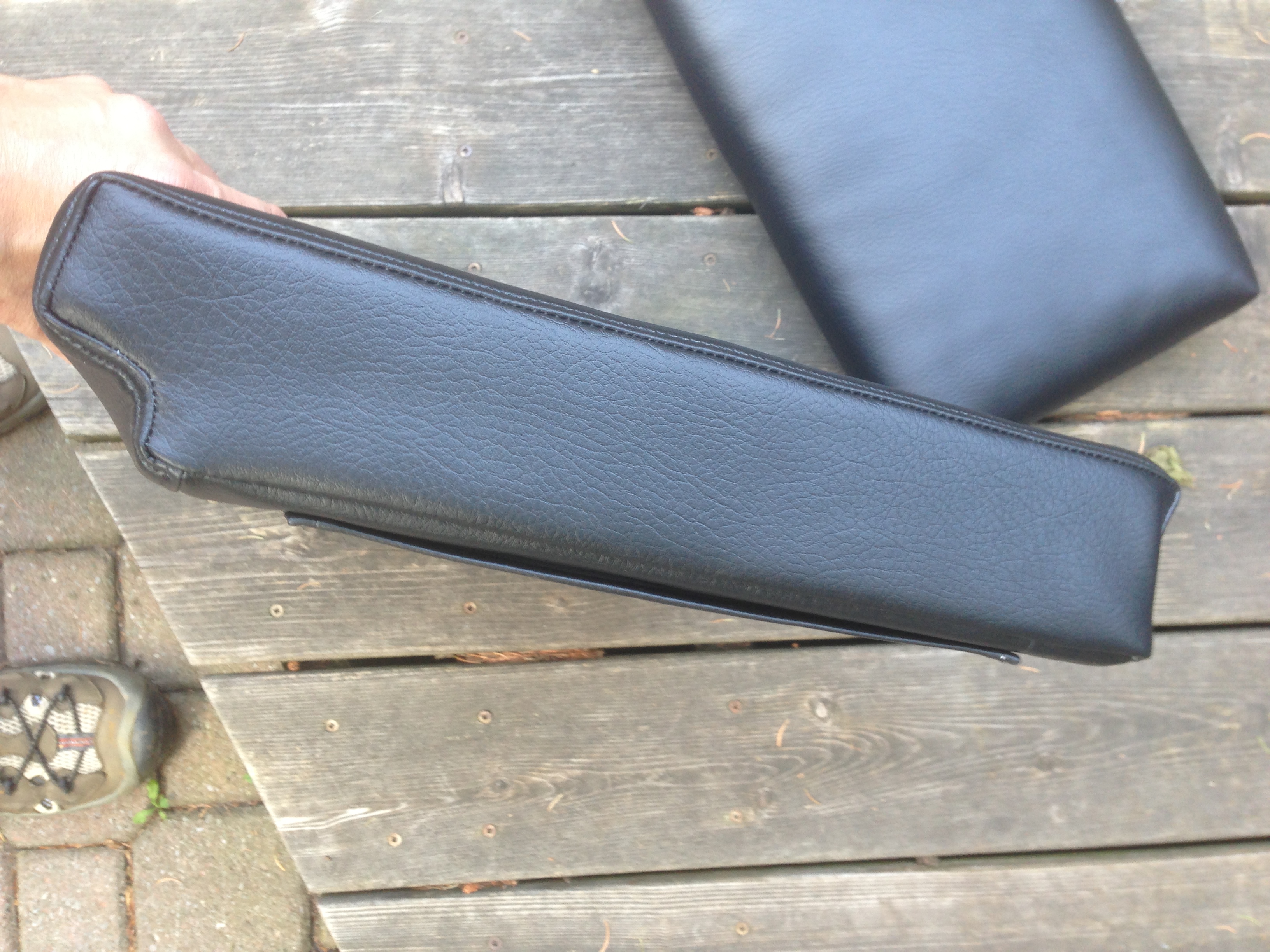

Rear seats are done.
Hope to do a test install this weekend.
Had 2 sets made up - 1 for me and one for guy that purchased my 71 Hafi.
I am really happy how they turned out and the vinyl I used should stand up to about anything as it is pretty HD.
Guy that made them said they were a lot of work (mainly the hand sewing with the think vinyl) but he would be willing to make more if anyone is interested (if interested PM me - they are not cheap but I don't think I will ever need to replace these ones).
Finished product: If anyone wants a set of the bottom seat foam I have 2 that I am selling or will trade for something small . The white foam is pretty soft but someone may want it? Value is only about $20
