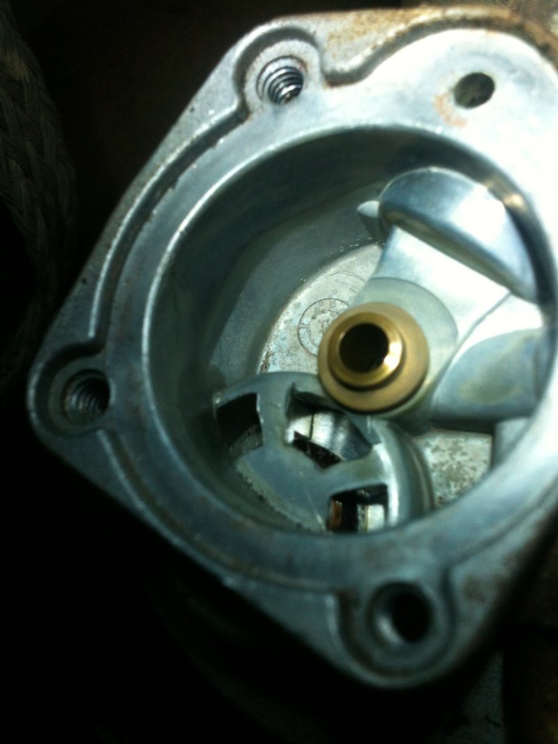

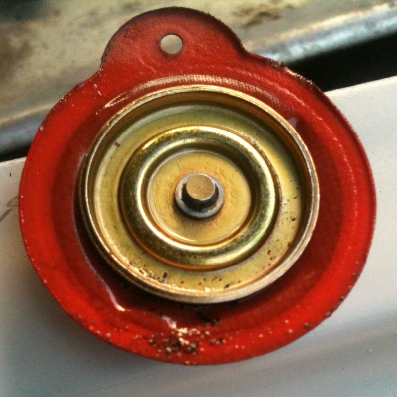

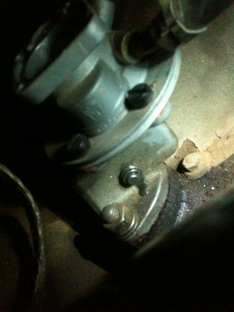

Thanks for the tip. I took the top off but it doesn't look as though the diaphragm is keen to be flipped. It has a tab on one side so it can't be rotated, and a cute little can on the bottom, not one on the top. I did notice some fine sediment in the top of the diaphragm, as can be seen in the picture. There also is a new grease looking leak that has been growing since it died (wasn't there at all when I first pulled hoses on the pump. This is in the first picture on the outside of the lower part of the pump.
EDIT: Sorry these pictures turned out so huge. Tomorrow I'm going to check for cracked hoses and maybe drain the tank and peek around inside as best I can. However, the previous owner has a log showing all fuel lines replaced in July 2011, a previous hose in 2010 and yet another hose before that in 2009. Fuel pump replaced in 2010. Based on the sediment, I suppose I need to figure out how to clean the carb jets. Are there different jets to use for different altitudes, or are they adjustable?

Re: dry carb bowls
The grease is normal. It usually is packed into the base of the pump to lubricate the pump lever and tappet (01-45-02 & 01-45-31).
Check the fuel strainer (01-45-17) on the pump and see if it also has sediment in it. The strainer is fragile and expensive so be careful cleaning it.
It seems odd that sediment made it thru the fuel filter into the pump. Maybe the previous filter was defective?

Ah, so that is what the tappet is! I saw it in the maintenance schedule but could not find it in the manual. How does one check the tappet clearance? 0.20mm
The grease just seems odd because there really wasn't any there until I really started cranking on the engine, then it slowly started seeping out around that pin. Perhaps a coincidence. What also is odd is that (01-45-10) had the sediment on top, but not on bottom.
The fuel strainer is so incredibly clean I can't even believe it. There is not even the tiniest speck of dirt in there or anywhere near it, and it looks to be in great shape.

Re: dry carb bowls
Clean the diaphragm and put her back together. Try again.
Your diaphragm is different than the one I have, but doesn't look damaged.
