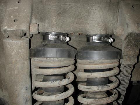

Found this as I was searching around:
- Spring Cup Covers.jpg (30.4 KiB) Viewed 7427 times
