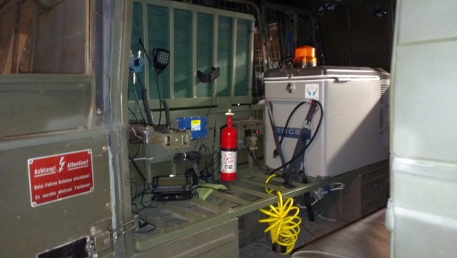

we use the Norcold/Engel fridges in AZ. They come up on Craigslist from time to time. Yes they are $400-$450 range but worth every penny. The units we look for are the 60qt models. the compressors are far more energy efficient (max draw at 3amps) then a regular fridge and are designed to be bounced around (which we do a lot of). These units also run on 12v, 24v or 120v so lots of options. I always suggest a 24v outlet next to the fridge in the event something goes wrong with the 12v supply. The addition of a solar system from Harbor freight and a battery and you are all set up for unlimited time in the desert heat (food and beer supply pending). Mark has been running this setup around 3 years now and I have had mine for a little over 2 years. Never unplug the fridge and always keep it stocked with my favorite beverage. best thing is you can go shopping for the groceries days in advance of a trip and just put them in the truck. If you have kids you know the advantage of not placing food in the house fridge that you are setting aside for a trip :lol:
