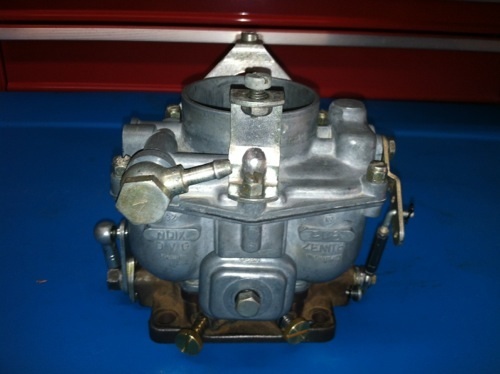

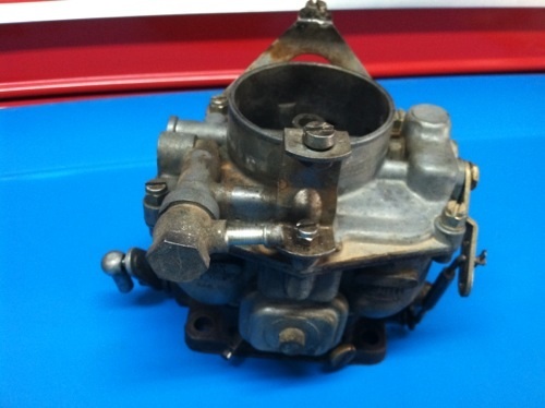

So I dedicated a few weekend hours to rebuilding my Zenith 32NDIX today. When I got my Hafi, the carb was loading up badly when the throttle was pressed. You could see fuel pour into the right side throat, and none in the left side.
So..
Disassembled, soaked all metal parts in a parts cleaner bath (20 mins per dip) and brushed and reassembled.
Used the Hafi NDIX rebuild kit sold by SAV, for what it's worth.
Things came apart OK, and went back as before. Bowls were a mess.
It's all clean now.
Before;
After;
So here is my problem;

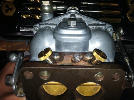

The carb had a mystery left volume control screw installed. Upon review, it looks like a Solex screw.
I have 2 new and correct volume control screws now.. and they were the last pieces installed.
Right side went in just fine, but the left side was apparently damaged by the incorrect threads on the bodge-job Solex screw. The new unit will NOT screw in.
Do you folks think a tap with the correct thread size (if you know this, please tell me) will do it, or do i need to Helicoil the thing to do it properly?

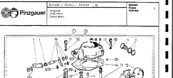

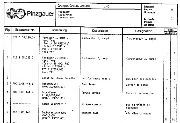

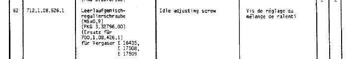

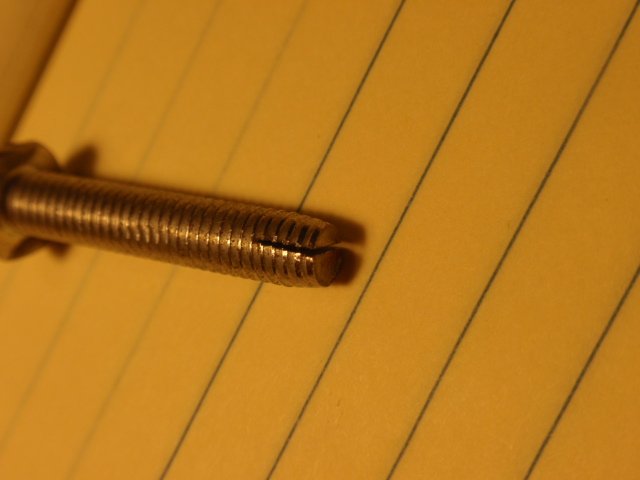

Jim L has indicated that the top screws on the Zenith 32NDIX are the same thread as your air screw. I don’t know if the Zenith 32NDIX and the Zenith 36 use the same size top screws however the screen shots are from the Pinz spares book and provide the screw call out and also the thread info for the air screw on the Zenith 36.
Also is a photo of a screw I modified for use as a tap. You could modify your good old / spare air screw for use as a tap by, cut off the tapered tip, blunt the first 2-3 threads and cut a slot using a dremel with a cut-off wheel or use an xacto saw blade to cut the slot. Not the best tap and you may need to remove it often to clear the chaff however with patience and a little oil it should work if you can’t locate the correct tap.

So, am I reading this right.. its an M5 x 0.90 ?
Weird (but not surprising..)
Thanks edzz!
Thanks edzz!
Re: Volume control screw.. ed me!*
M5x0,9
I'm not good at interpreting metric speak however the screw shop should be able to make sense of it.
Also like I wrote this is info from the Pinz books and I’m only guessing that the 32 and the 36 have parts commonality.
