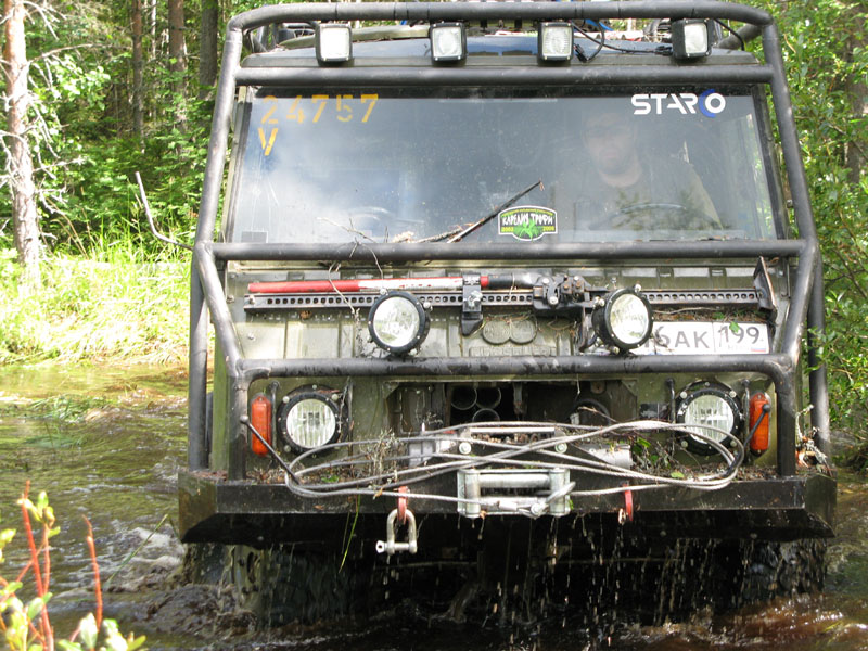

Here is my Pinz 8)
Still playing in the mud

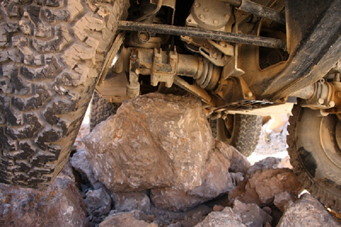

same thing happend to red bull pinzgaure cause was tire contact with the underside of the body while on an obsticle and the tires were not aired down and were to tall

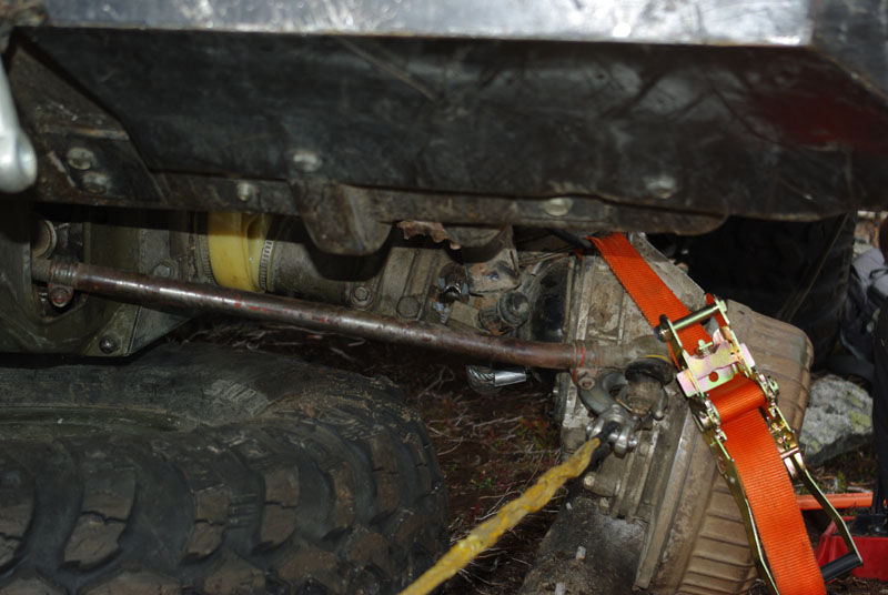

Re: Axle problem
Post by Andre »
here is an image
Re: Axle problem
Near the bottom of the web page in this link http://www.billcaid.com/2009/MogFest200 ... Part2.html are more photos of the incident Andre posted a photo of.
According to Mike (the owner) and Jim (one of our expert Pinz mechanics) the repairs required were not extensive and due to their level of ability were completed in a relatively short time once it was back at the shop.

As i understood the reason at that case was the big rock! It was a hard blow to the axle! In my case there was no blow at all! Soo i still have the question about the reason of the failure!

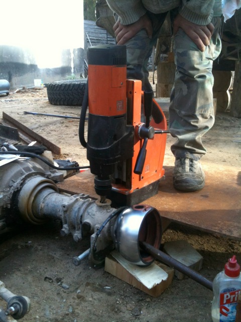

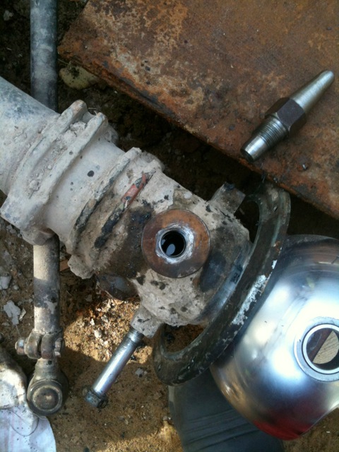

Green Crocodile
Posts: 19
Joined: Tue Sep 17, 2013 5:28 pm
Re: Axle problem
Post by Green Crocodile »
Here is a method of strengthening the front axle, which made by ​​my friend! He made a new bolt for the spring cup, which has the same cone, an inch longer than the original, and the same length as the locking bolt down! Then he drilled a hole in the inner part of the axle...Working good yet! 8)
One problem to do this you need to disassemble half of the car! :roll:
