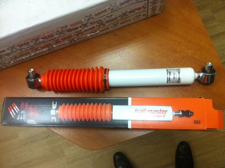

By the way I use Trail Master shock absorbers! Does anyone use those? I use them a few years, are pretty good for me, but the truth is I did not use the others!
- shocks.jpg (163.91 KiB) Viewed 7053 times
