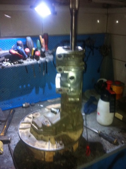

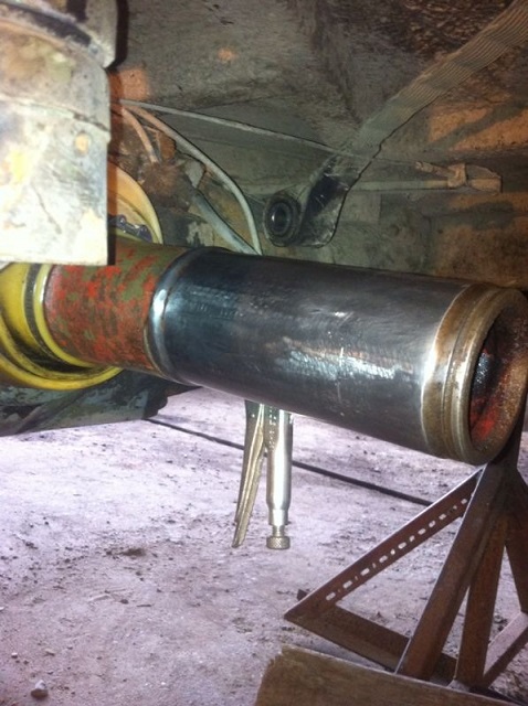

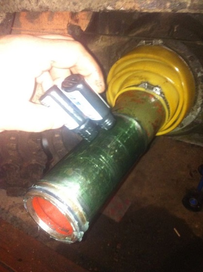

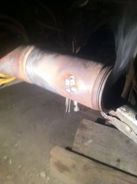

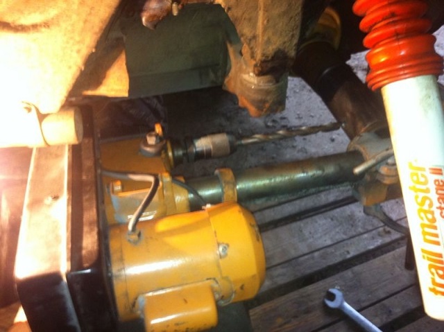

Finally finished repairing the rear axle! :D I had to weld completely two old holes on both parts of the axle's tube, drill new holes for the locking bolt, and cut a new thread. During assembling at this time we used the analog of Loctite, hopefully in the nearest future i won't need any repair of the axle!
